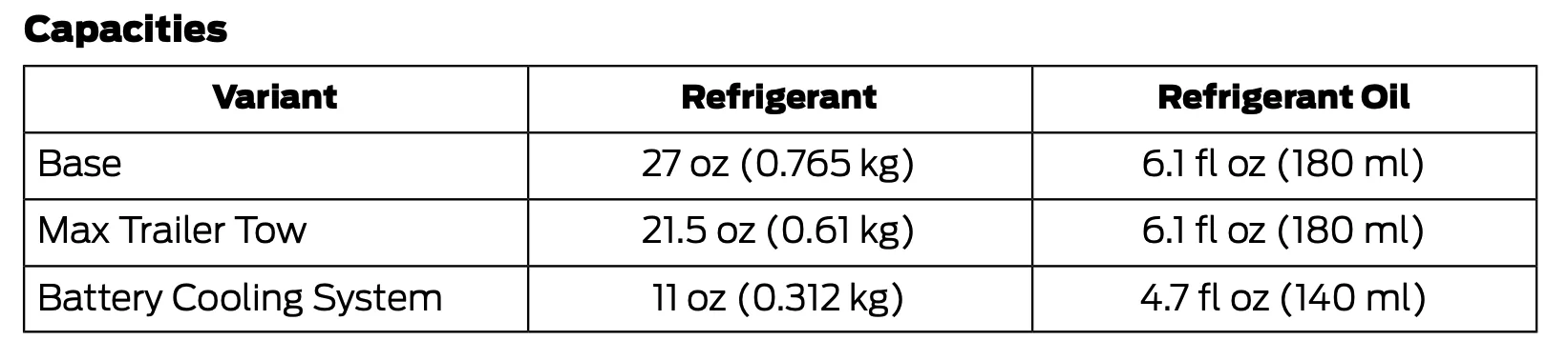

These are the "refrigerant" capacities listed in the 2023 Owner's Manual. Maybe someone can enlighten me...trucks with max tow would get the 21.5 oz of refrigerant plus 6.1 oz of oil in addition to the BASE 27 oz of refrigerant plus 6.1 oz oil for the "cabin" system. So does that mean a total of 48.5 oz of refrigerant and 12.2 oz of oil. What is the additional 11 oz of refrigerant and 4.7 oz of oil listed as Battery Cooling System for??? Just curious...I do not have the equipment or skill to touch any of these systems.

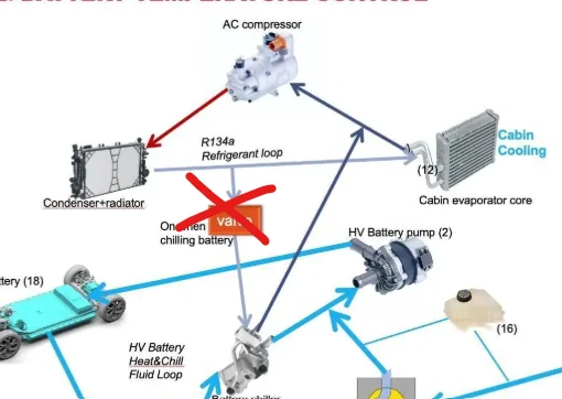

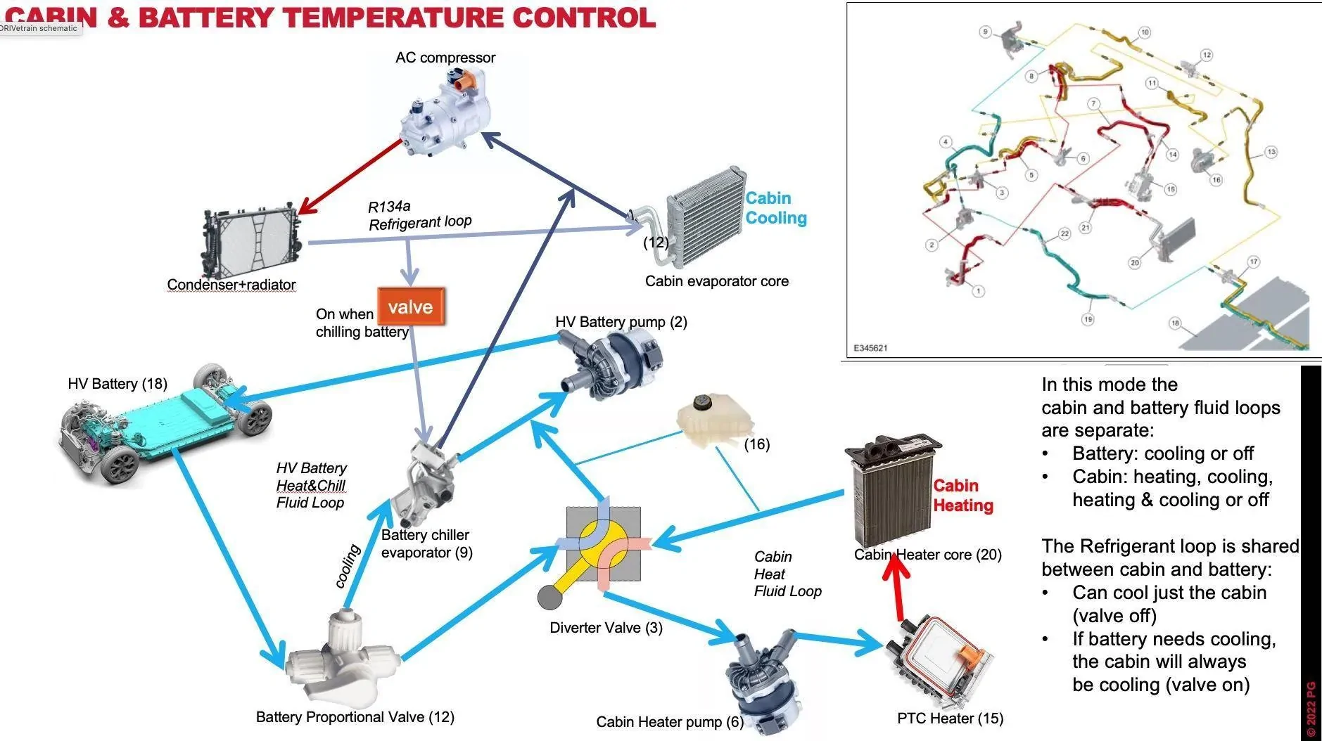

There IS a 'freon" based HEAT EXCHANGER to cool down the glycol based coolant.
Yes, Glycol circulates in the HVB and drive motors.
The drive motors have an OIL to GLYCOL exchanger as well, moving the motor heat to the battery pack in winter and further up the coolant conversion process to the freon based heat exchanger to boost heat extraction when the GLYCOL radiator can't cut the mustard.
Item #9
Aha, interesting.
I see now, the refrigerant R-1234yf (Freon substitute) can be used to cool the P-OAT liquid cooling the battery by passing through that item 9 "battery chiller evaporator" controlled by the box labelled 'valve."
I missed that, so I was wrong - the refrigerant IS used to help cool the motor and battery.
My bad.

We don't have exact diagrams of the Max Tow system.
The first graphic I pasted above is actually from a MME, we speculate that Lightnings without max tow are designed in the same fashion.
What would be distinct on MAX tow trucks is a second AC compressor which is directly connected to the chiller {#9} with no diversion piping between the primary AC compressor which would then have the sole task of cooling the cabin.

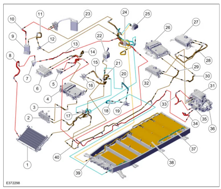

That's where my confusion came from...
I've read this but never found a diagram of the whole shebang:
"Upgraded Cooling System: Adds a secondary battery cooling loop, high-capacity radiator, and specialized cooling lines to the battery pack. This prevents battery thermal throttling under heavy, sustained loads..."
Maybe a parts supply site or a service manual would have an image - just haven't located one yet...a lot of images to sort out, just haven't had the time...
