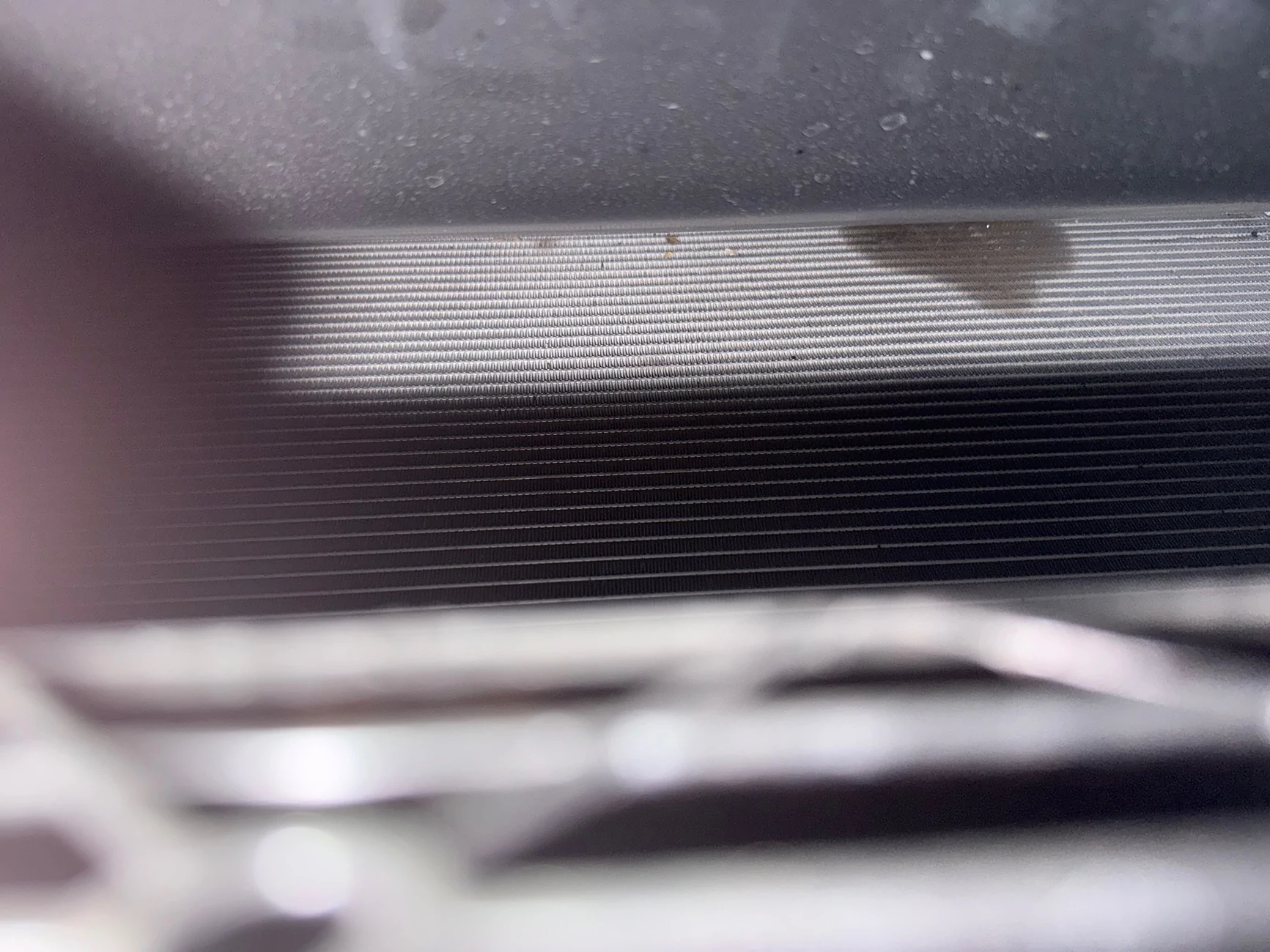

Anyone have an idea about this dark spot on the upper part of my radiator. I’m afraid it may be a leak but thought I would check with the collective. I pulled a Kleenex and a few small leaves out of the radiator area but nothing like stones or harder debris.

Is that a picture of ur radiator or condenser? What does the coolant overflow reservoir show?

If still under warranty I’d consider bring it in to be looked at. But you could also take out the frunk tub to get a better look at where it might be coming from.

Looks like the ac condenser.
Coolant tank was between min and max. I know it was on max last year so definitely down some. I brought it up to max and will continue to keep an eye on that.
I may not have my terminology correct by calling that assembly a “radiator”. I have the max tow package so that being the case this is a split system feeding two separate compressors ???
I just went over 3 years a couple weeks ago. My plan is to wait for parts to be available for the light bar recall and have the dealer look at it then when I have to take it in for that service.
Only one ac compressor that I'm aware of.
Munro Live episode on the Lightning cooling system shows the Max Tow package adds a second compressor.
Cooling system and refrigerant system for the ac are two separate systems. Regardless of any of that, it still looks like the ac condenser is leaking.

This video explains the HVAC system:
But was that your heat exchanger that's at the front of you vehicle?
You mentioned leaves but no stones, so that's what I'm thinking it is - see this video:
In that case, it could be a coolant leak not an AC refrigerant leak (unless that is your evaporator) if I understand the arrangement of the systems correctly.
Keep an eye on your reservoir located on the driver's side of the truck under the frunk hood.
Mine just got replaced for leaking after 40 months and 56k miles (out of the original Ford warranty). Problem is the repair did not last long and it’s going back in next week to get re-fixed.

Took my truck in yesterday for the recall, the oily stain on my condenser, and I asked about the three year brake fluid change. I got the truck back today with the following.
26SB6 Lightbar recall: The truck passed the lightbar recall inspection and Ford approved the pictures. So recall complete for me and no parts needed.
Oily stain on a:c condenser viewed through louvers. Truck is out of warranty so paid $200 for an A/C diagnostic to check on the greasy looking condenser stain. See my post on this stain.
https://www.f150lightningforum.com/forum/threads/possible-radiator-leak.36407/
No leaks found. They pulled all the Freon from both systems (max tow package) and found no decrease in specified levels. They cleaned the stain for me and I guess I’ll just monitor cabin, battery, and motor cooling.
