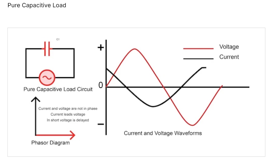

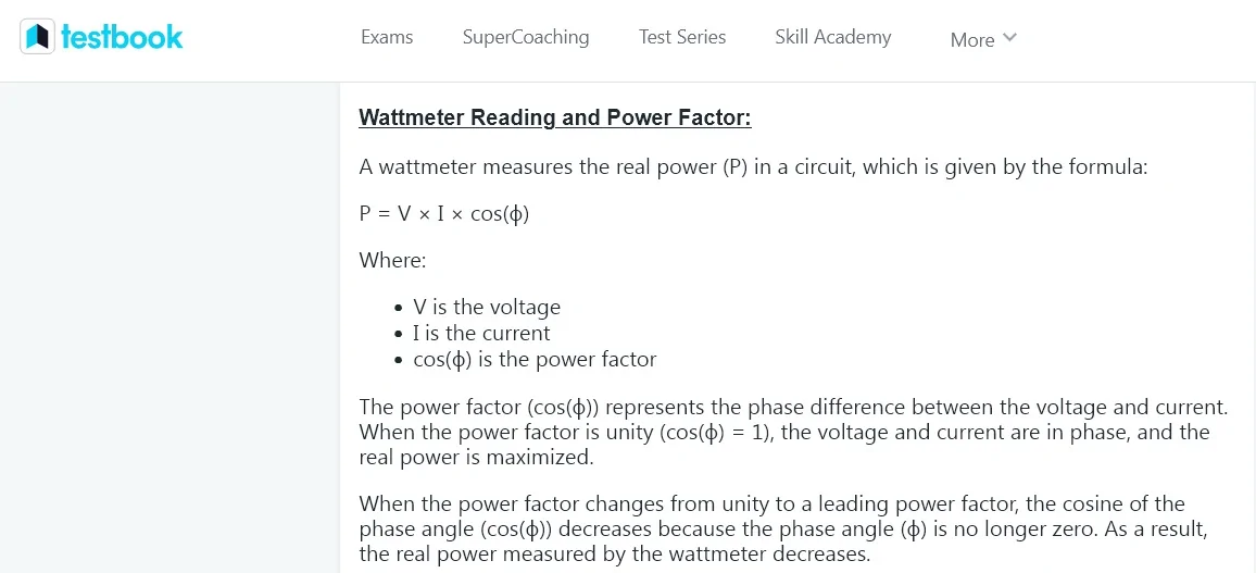

The following might clarify it from a mathematical point of view:
Ford F-150 Lightning Power Leakage from DC Power Supply power factor watt meter
From: https://testbook.com/question-answe...a-wattmeter-when-th--666d94691201eeeeb0bd9f67
So your circuit, the power supply, may have a leading power factor due to it being a partly capacitive load on the Lightning output - the current peaks before the voltage.
Ford F-150 Lightning Power Leakage from DC Power Supply capacitive load
From: https://eepower.com/technical-artic...-much-electricity-your-power-system-consumes/
In reactive loads, the power factor is not one (it is less than 1), so the real power is less than it would be in a purely resistive load.

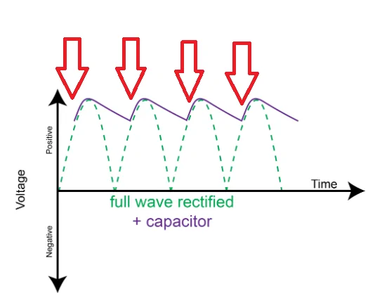

No, there is not that much loss. If it were, you would not be able to touch it because it would be massively HOT. It's a metering difference / difficulty caused by a crappy power factor. And as I pointed out earlier, it's not just the capacitive load, but the very likely seriously non-sinusoidal current. In the drawing below, the only time that the power supply is drawing current is during the portion of time where the dark line is sloping up (where my red arrows are).
