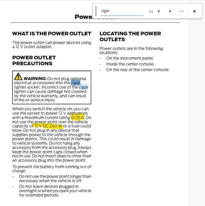

Now that I understand the point of your query from subsequent replies, the CIG lighter outputs on vehicles have a limit based on the wiring, in the truck and wiring in the powerbank, so that's the limit right there.

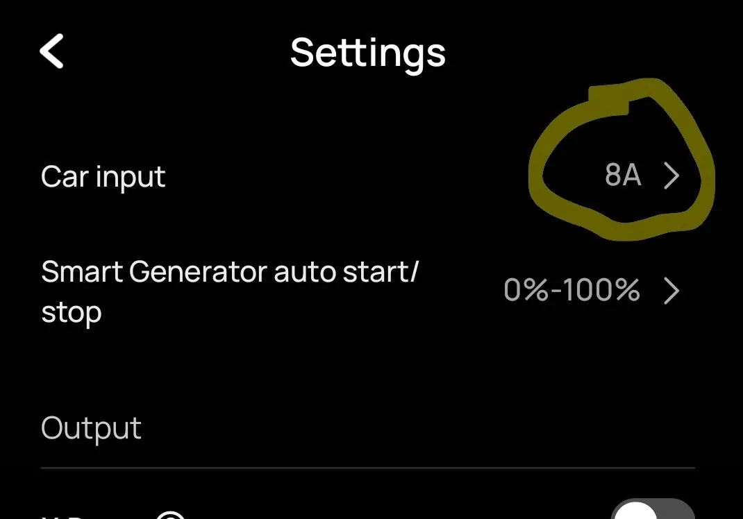

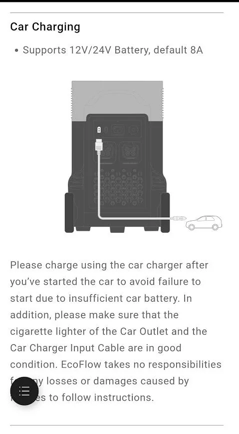

As an example, my EcoFlow Delta Pro power stations can only take ~96 watts via that route, 12v x 8 amps
Ford F-150 Lightning What's the highest power one could get from a Lightning over DC? 1733876182441-w4
Direct connection to the 12v LVB in the Lightning which would be a buffer for the energy coming from the trucks onboard DC/DC converter would be limited not so much by the trucks capacity but by the input limit of the Zendure power the OP is discussing, I'd venture to guess his like mine won't tolerate that much more, I don't have that systems maximum input specifications at hand.

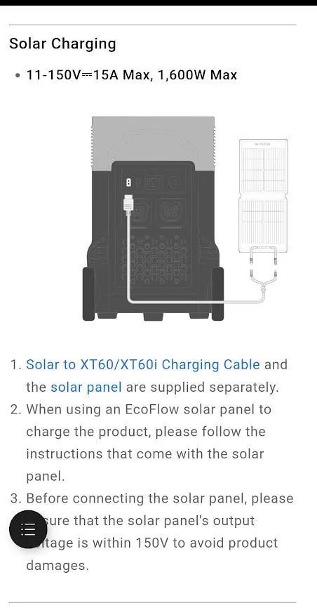

The EcoFlow has a solar input connection XT60i, 1600 watts with a range of DC voltages no higher than 150 VDC @ 10.5 amps
Ford F-150 Lightning What's the highest power one could get from a Lightning over DC? 1733876572341-fj
Ford F-150 Lightning What's the highest power one could get from a Lightning over DC? 1733876585482-qv
The Lightning can only offer 240 watts on the Cigar 12v output.

…edit… your schematic shows solar input, at all voltage ranges, is limited to 15amps. So the most watts you could get, connected directly to the battery, is 225 watts. That’s super easy on the trucks system.
