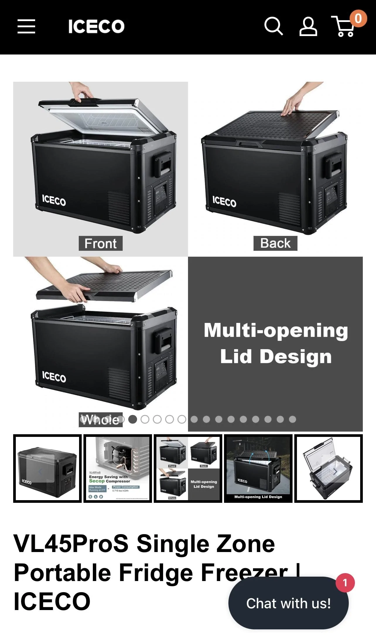

I was going for a Dometic but the cost is nuts. Ended up finding ICECO and it’s amazing. Same compressor as Dometic but tuff and good looking. The ability to run on DC and AC helps.
