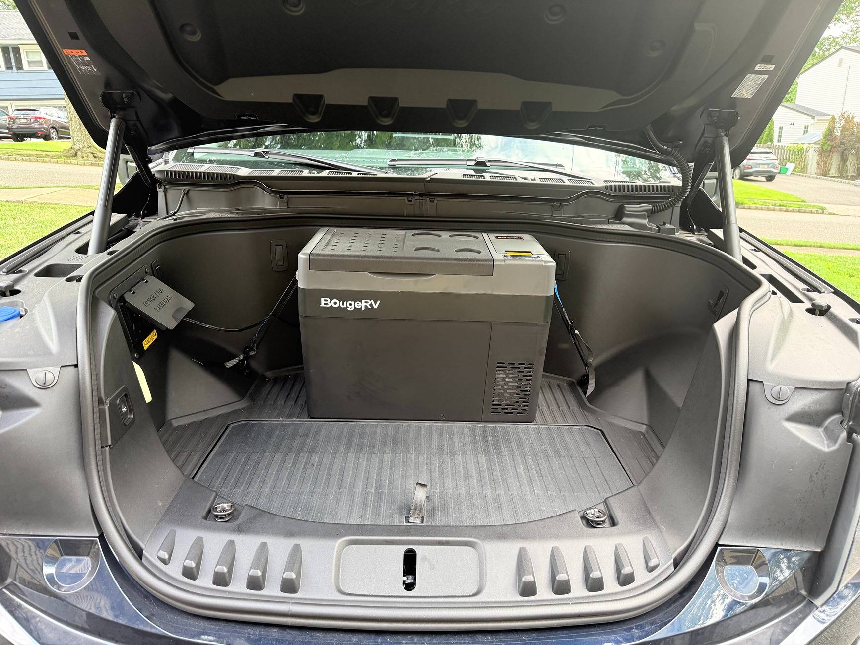

I figured I would update on how I solved my issue with PPOB shutting off.
Lasko 350CFM Mini Blower. Pulls just over 100 watts at the 3rd speed setting. Additionally, it cools the compartment and allows the fridge to run more efficiently in high temperatures.

I'm doing this now but with a ecoflow Delta 2 in between the truck and the "ice" chest for ice cold drinks at any moment but The problem I'm running into is with the frunk closed the PPOB turns off and I get an alert from Ford pass saying I'm using more than 175 watts even tho the truck says I can only use 400 watts when I turn it on. Is there a setting or something I can do to get the PPOB to stay on while driving with the frunk closed?
Photo for my setup
I assume what you are describing is plugging the Ecoflow into the truck's 120v outlet and plugging the powered cooler into the Ecoflow.
Looking ta the Specs for a ecoflow Delta 2, it draws 1200 watts when charging on a 120VAC outlet. That by itself exceeds the current limit allowed with the Frunk closed.
My cooler works fine directly plugged into the truck's outlet with the frunk closed.

Yes this is how I have it set up. The Delta 2 has adjustable charge settings I have it set to 200 watts. With the fridge running the max the truck sees is 260.
Got it. It’s a nice feature that the ecoflow charge current can be adjusted.
According to Ford documentation the front outlets are limited to 400 watts when Frunk is closed. If this is accurate then 260 watts should not be enough to turn them off. I don’t know of any user setting that can adjust the limit. Sorry I couldn’t help.

Exactly! But as soon as it gets over 200ish Watts it turns off and an alert on the screen pops up saying it can't pull that much power and I get a notification from Ford pass that says you can't be more than 175 watts
