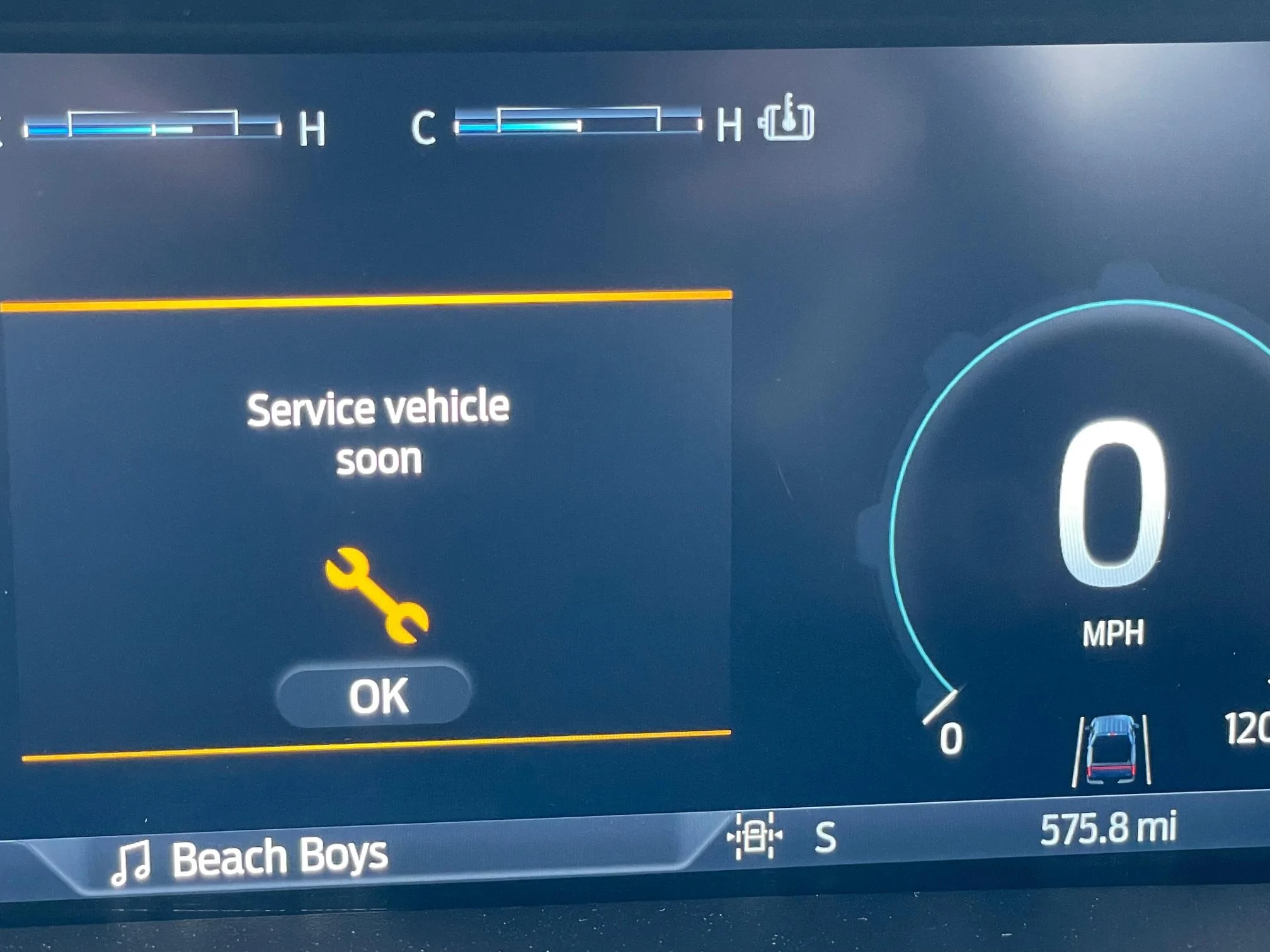

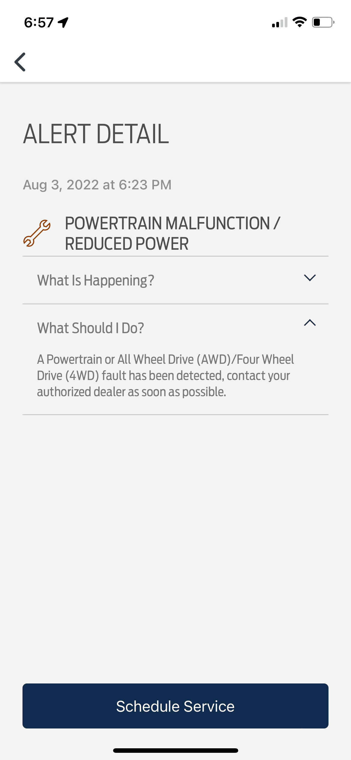

Drove home from work and stopped for dinner. Got in the truck to drive home and had an error on the Dash and it sent a message to the App. The dash message was simply "Service Vehicle Soon" with a wrench. Got a message on the app that says "Powertrain Malfunction/Reduced Power". Pics attached. The truck seemed to drive just fine.

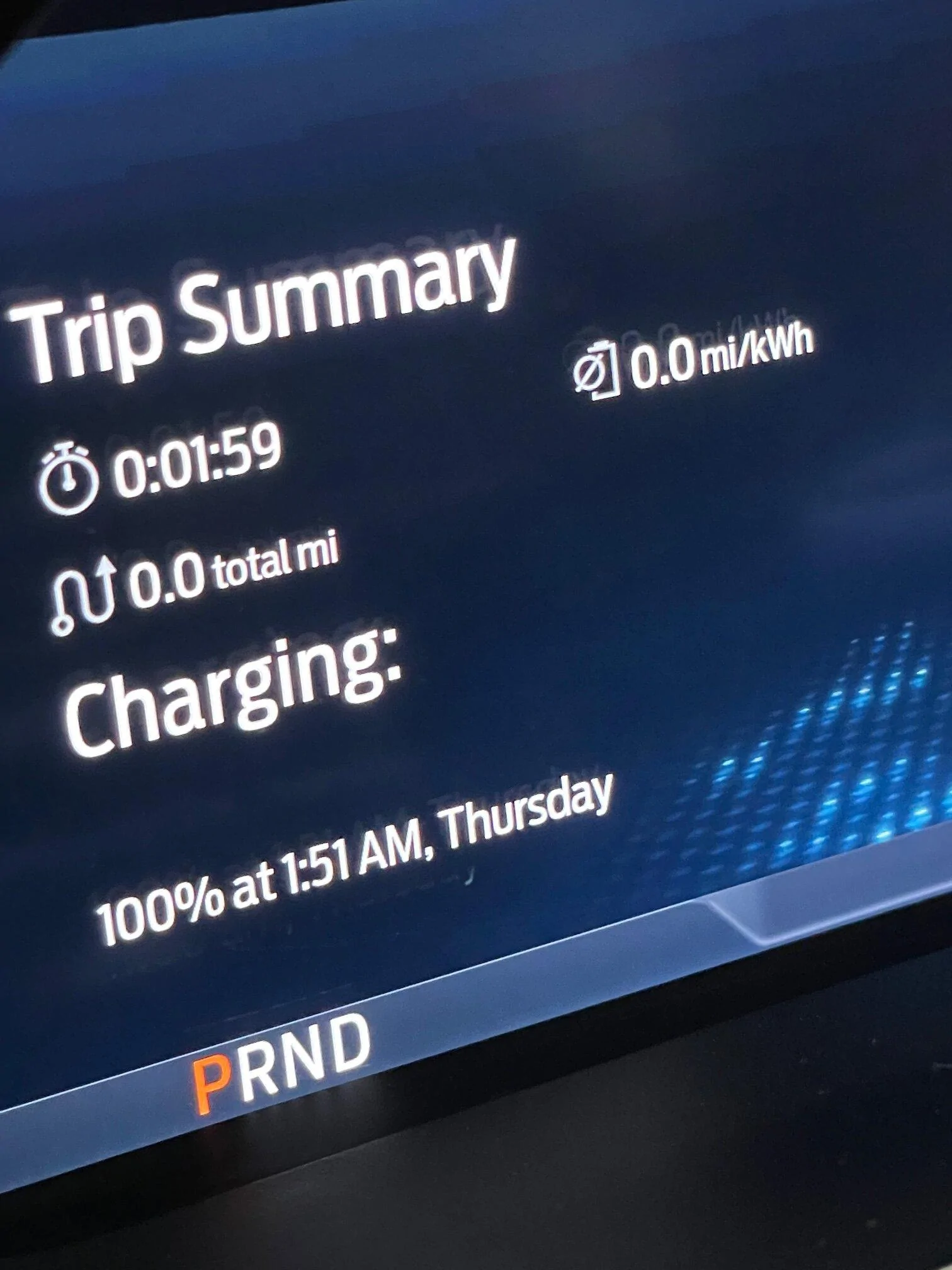

When I got home I plugged in and adjusted my schedule from the app so it would start charging right away. It didn't seem to be charging, so I unplugged/replugged and removed my schedule from the app, It has started charging for now. Will schedule service and touch bases with the dealer.
