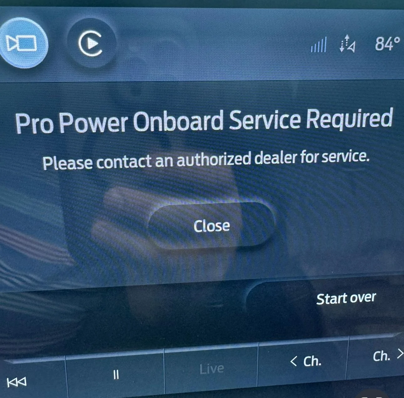

Got this message several days ago when I was trying to change/reduce my pro power settings.
It did not happen again…yet…after fully charging overnight from 17% to 100% for a road trip.
Never seen this message before, has anyone else seen this before on there trucks..??
Possible aberration, test the system to confirm power output.
The following thread, was dealing with other matters, but a few reports of the same message.
https://www.f150lightningforum.com/forum/threads/pro-power-problem.16676/#post-335779

I've seen these type of 'alerts' several times over the last almost 2 years, and don't pay attention to any of them. They go away on their own. Do not rush to any dealer. They don't know how to help, anyway. Most of these alerts are like the 'dummy lights' on gas cars, where you forgot to twist the gas cap 'exactly' three ticks... the 'engine light' does not mean the engine is failing.

Thanks I’ll read other thread and take this with a grain of salt for time being until a true failure or something that can be replicated to be fixed.
Idiot lights lol ? yes I remember those days….
Looks like those days are coming back again.
