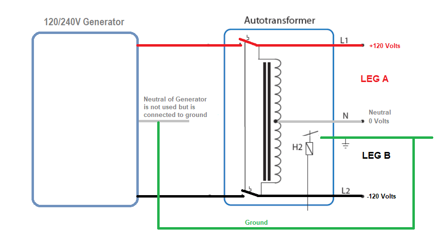

Hmm ... maybe we are saying the same thing. The main purpose of the autotransformer is automatic load balancing between the 120V legs. I don't think you get that connecting directly to Pro Power OnBoard. This is the setup I have used with 240/120V generators without problems:
Ford F-150 Lightning Pro Power OnBoard with Autotransformer -- to work around the bonded neutral issue? 1678042181985
The diagram is from https://shop.pkys.com/autotransformer.html.
I am interested to know if there is anything in the Pro Power OnBoard that would make it not work in the same setup.
4,200
5,565
It does load balance by presenting the 120V loads to the genny as a single 240V load.
But it’s not going to solve GFCI tripping.
