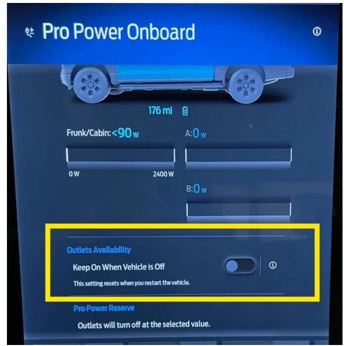

I was wrong about needing the 25-13.12 - if you have a 2023 truck, it's the 25-8.5 required.
I had misread the post as saying I needed both.
I also thought the toggle was in the APP but now I realize it must be on the truck screen - my bad!
Enable Pro Power Onboard with truck off (2022-2023 only. Standard on 2024+).
In the settings that follow, “x” means leave the value as is and
-“ is the checksum value that FORScan will re-calculate for you when you write the data.
An " * " means the new value depends on the old value so read the notes.
While all the settings can be done using As-Built Mode, some can be done with “Easy” mode. Both are shown where applicable.
Creates a Sync toggle in the Pro Power settings screen.
See this post for operational details.
This mod requires a PCM update that came out in early 2025 via FDRS. However, the Charge Port OTAs that came in early 2026 will also work (PT-25.13.12 and PT-25.8.5).
7D0-10-03 xxxx xx2x xx--
7D0-10-04 xxx* xxxx xx--
If 0, change to 8.
If 4, change to C.
If 6, change to E.
If you enabled the Advanced Charging Screen, you likely have a 6.

I am running the PPOB test now with the truck off, to see if the problem you had with the reserve is due to the update you mentioned or if it is your 12V battery being weak.
I set the reserve at 119 miles because it would take forever to go down from over 200 miles to anything lower. Our house emergency circuits don't use more than 1kW unless I run the microwave or have the coffee pot on, then we barely get to 1.5kW and only briefly.
So far, nothing unusual at 197 miles and still hovering around 90% SOC.
If it cuts off before the 119 mile threshold, then we'll know the update screwed the pooch.
But I'd bet it was your 12v battery issue, a weak one manifests in so many strange ways in our trucks...
I lost that bet - it happened to me too!
chl
CHRIS
Dec 16, 2022
3,985
2,471
alexandria virginia
So, I was running PPOB, set the threshold reserve limit to 119 miles - I started at 90% and 209 miles range.
Ran fine for several hours.
I started out running PPOB with truck OFF, but turned the truck ON and got in it because the APP was not showing any change in the HVB SOC or the range at some point.
Also, when I looked outside, my FRUNK had opened by itself!!! That was a behavior someone else reported last week I believe. My doors were still locked however. I thought maybe that is a sign the 12v battery is running low, so I got in and turned ON the truck after closing the Frunk.
When I turned the truck ON, the APP updated with the accurate numbers being displayed on the dash screen.
The PPOB ran for some time after that, maybe 30 minutes but...when it got to 191 miles range and 87% SOC, the PPOB shut OFF.
With the truck ON, the 12v battery would be being charged, and up until I started this test, the 12v had been on a maintainer, so even if during the test, the 12v battery was drained somewhat, turning the truck ON should have started restoring charge to it.
So I cannot connect the 12v battery SOC to the behavior of shutting down the PPOB way before the reserve threshold had been met.
In the past when I used the PPOB for several hours, it did not shut OFF before the reserve had been reached, I shut it off manually after several hours.
So, I have to agree that this latest update, the PT-25.8.5 messed things up.
