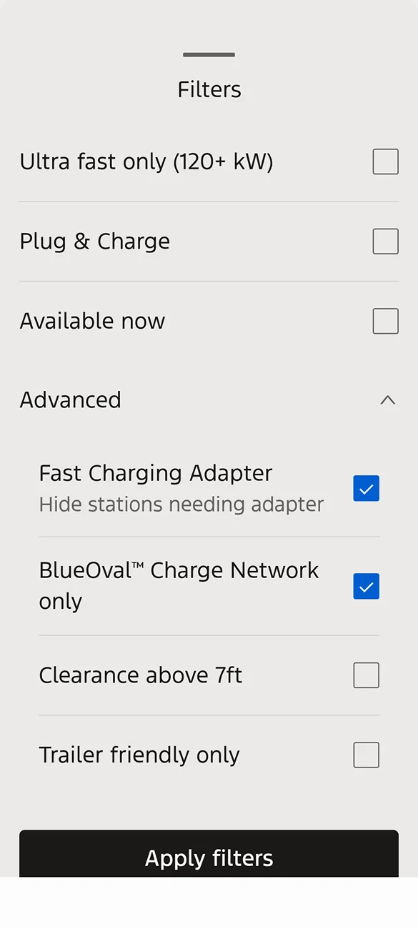

I have not fully tested mine but when I choose closest charger, it too defaults to 10 miles. Meanwhile the closest is 2.
Some update also took out the reserve from the app...see my past post quote...
Has anyone played around with the "search" setting for the type of charger? Does this make a difference? For example from the app, but also can be done in the truck.
Ford F-150 Lightning Pro Power reserve limit fails Screenshot_20260508-150656
The changes. I can now edit the name of target charge location in the app.
And the pro power now shows the frunk/cabin and bed outlets as separates when off, instead of a single statement item. Also it shows what I have the reserve set at. Before that did not exist.
