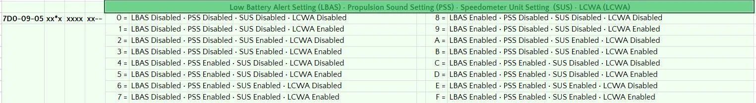

so to be clear theres no way to enable the in cabin propulsion sound if you dont have a platinum trim? 23 lariat lightning here.
Just responded to your message, but I guess I'll put it here, too.
APIM:
Ford F-150 Lightning Propulsion sound? 1749570301677-hi

I’m only talking about the in cabin population sound that makes it sound like an engine when you accelerate.
3,215
4,671
APIM:
Note:
22/23 Lariat and below will have a 8 here and Platinums a C.
24/25 Lariat and below will have a 9 here and Platinums a D.
(In 24/25 they turned on LCWA - whatever that is)
If you find anything else than these values let me know. Also if flipping from 8 to C (or 9 to D) works to enable the in-cabin propulsion sound let me know year and trim. I'll add to FORScan mods.
I thought it had been tried before though and failed.
EDIT: This may just enable a toggle in Settings to turn Propulsion Sound on and off. Be curious if it works for non-Platinums.

Just made this change. Adds the toggle but it does not stay toggled or enabled. Anyone know of another setting that might need to be changed?
