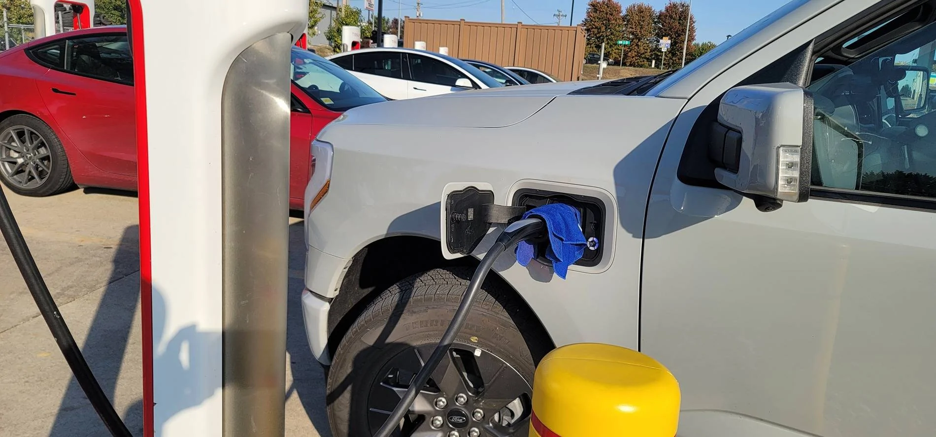

Just had it stop charging and had to cool it down with some wet rags. I'm not a fan of putting wet rags on this adapter that's connected to all the high voltage, but welcome to world of EV Beta Testing.
Ford F-150 Lightning PSA: Keep your Tesla NACS adapter cool 20241009_163037
Nov 12, 2023
Denver CO
2023 Lightning Lariat
Tesla owners have been doing that for years on the handle of the superchargers. But recently Tesla has introduced a software patch to detect if people are doing this.
