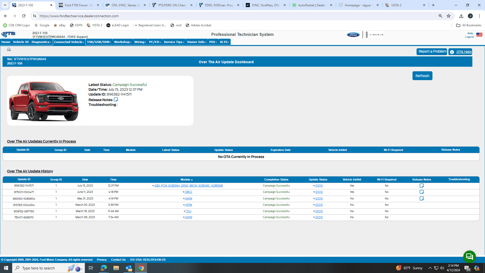

PTS is back up. OTA history is below. Last power up was 4.2.3.1 followed by a pair of PU updates. Nothing sent since. Looks like your VIN has not been added to the roll-out plan for 6.x.x and the newer string of updates yet.

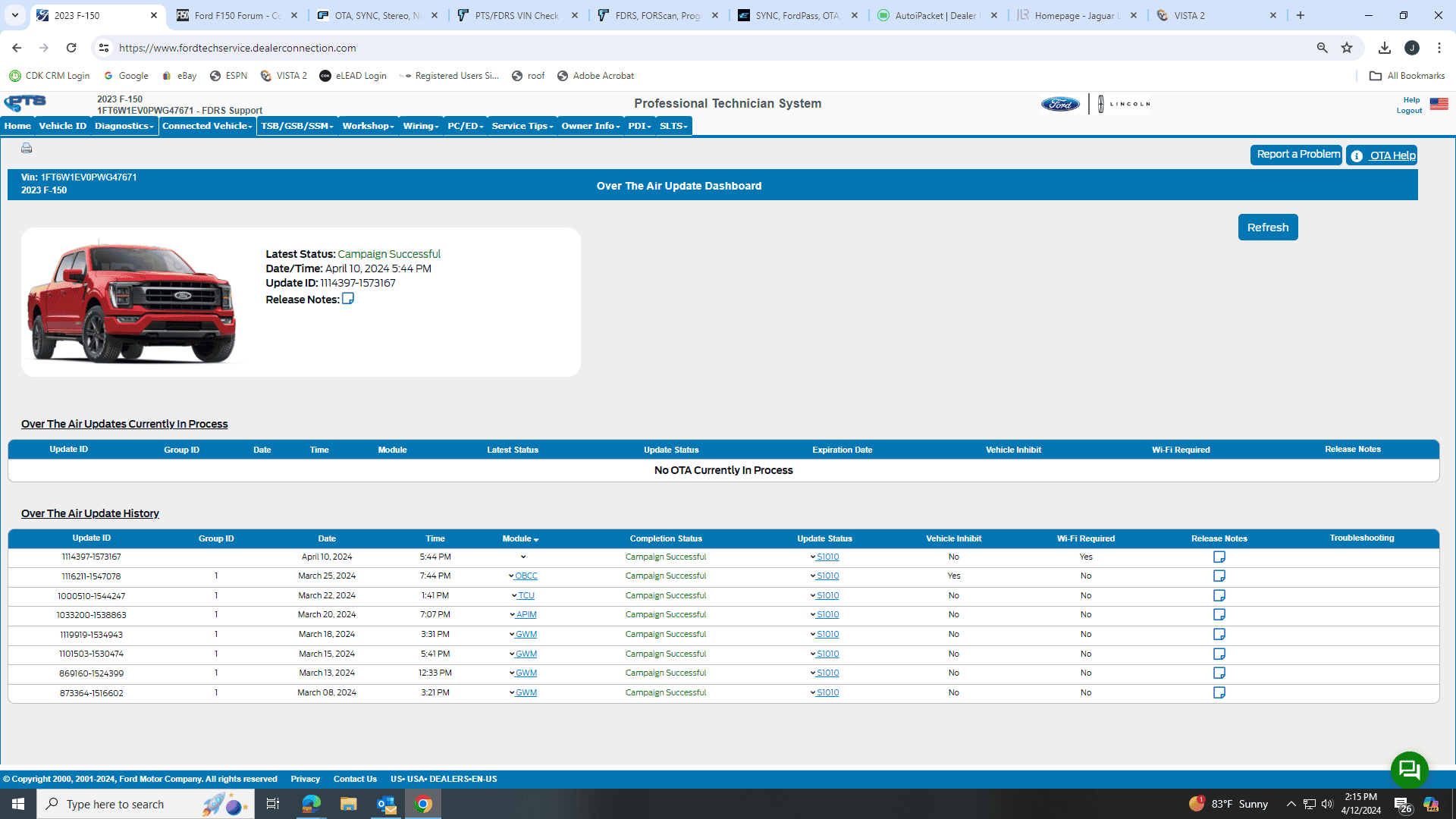

Thanks so much for doing this. If you don't mind, please check 1FT6W1EV0PWG47671
Your truck stopped at a different "trend" in OTA rollouts. Like a few others, last Power up you got was 6.4.0 followed by the Tesla update and connectivity update.
Ford F-150 Lightning PTS/FDRS VIN Check Thread 1712945796304-k2
I'm hoping you guys are following the thread and this helps to clarify how some of this OTA stuff works. Notice how many people "stopped" getting updates at the exact same step in the OTA rollout process. This is not a coincidence. More updates will eventually get sent when your VIN comes up again in the OTA roulette.

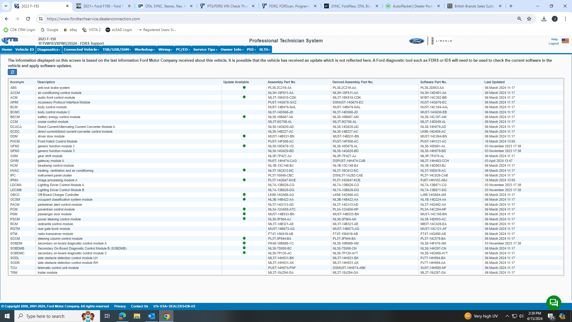

Could I have you check a new truck I’m buying?
1FTVW1EV1PWG38182
Thank you!
The last two times this truck was started, it reported many codes where the APIM was losing comms with many other modules within the network. I am not a tech and do not consider myself in an expert by any means. maybe it's nothing, but I can tell you after looking at hundred of vehicles that this is not normal. See attached. Also, the modem is still in fleet mode and would need to be activated as a retail unit for updates to come in.

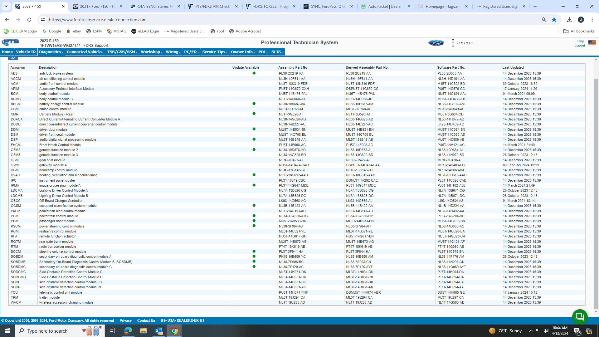

Please check this VIN: 1FTVW1EV8PWG27177
Thank you!
Very few updates are reflected in OTA history yet this truck is on the latest sync version. I'm a bit confused about that as vehicle history does not show any updates being done with FDRS. Modules pending updates are below.
Ford F-150 Lightning PTS/FDRS VIN Check Thread 1713019487526-c9
Thank you very much! I’m buying this truck from halfway across the country, so go figure there might be issues with it sigh lol. I’ve passed this along to the salesman to have them have the service team take a look.

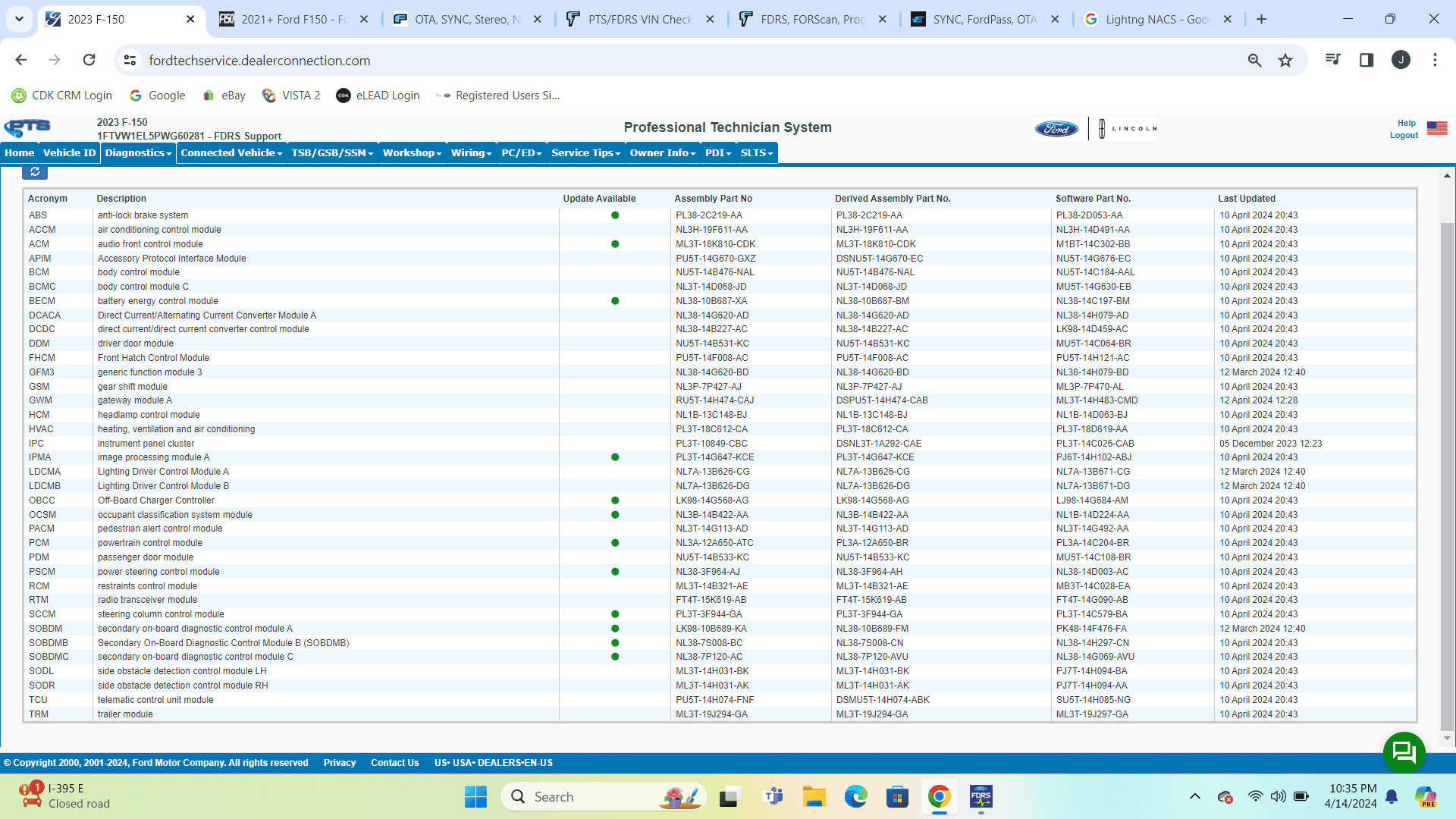

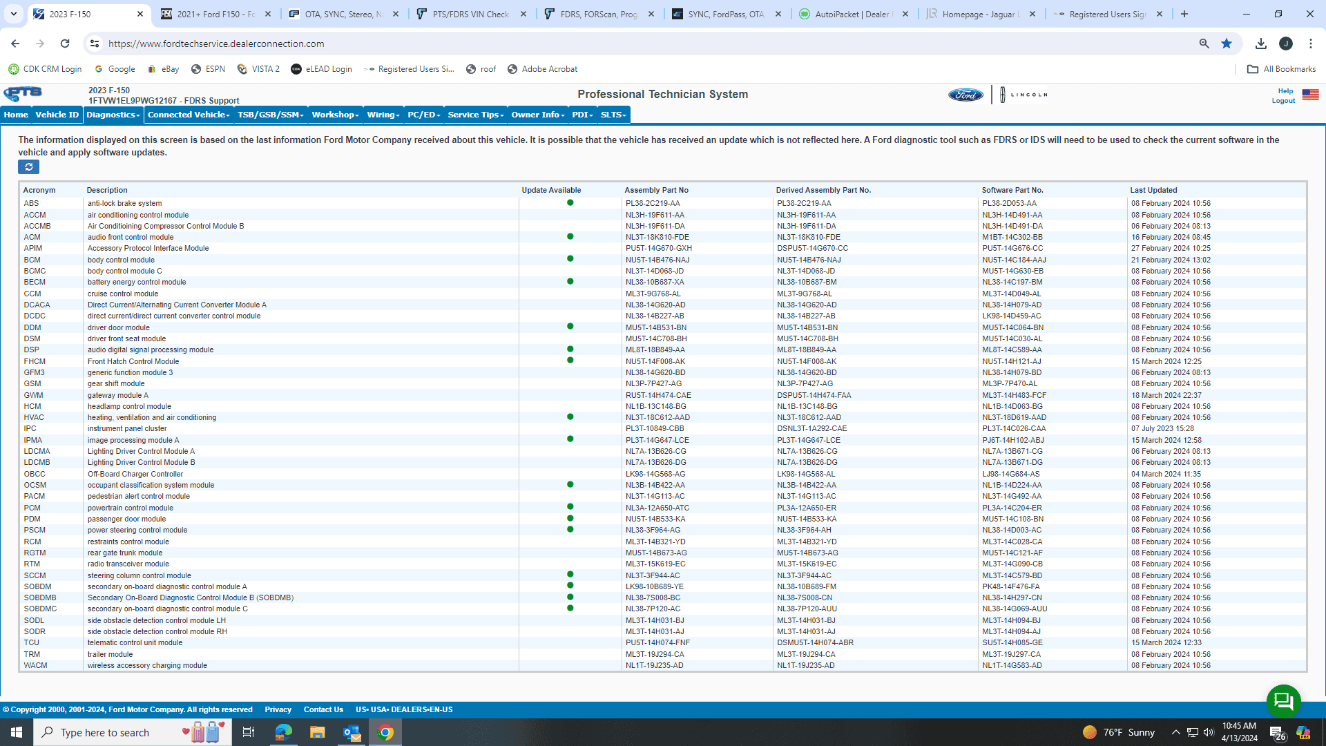

Not an EV guy, so not sure what that is, but if it has to do with the Tesla Superchsrger update, you haven't gotten it yet. Your list is below:
Ford F-150 Lightning PTS/FDRS VIN Check Thread 1713148601694-75
Please check Vin 1FTVW1EV2PWG37932
Assuming what you want me to check is what modules have pending updates:
Ford F-150 Lightning PTS/FDRS VIN Check Thread 1713148683760-49

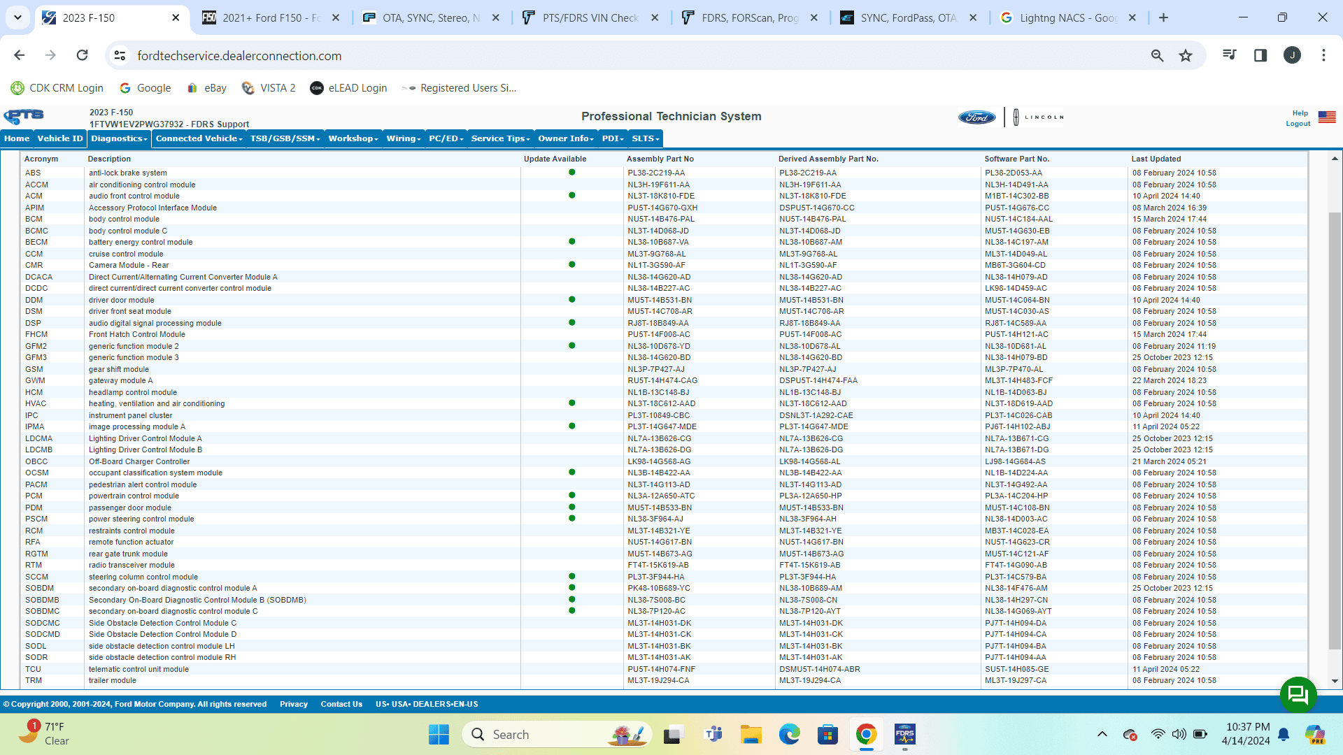

Please check fdrs. Thank you all for your help! Feel like I haven’t received any updates.
1FTVW1EVXPWG35524
No OTA's have been sent to this truck yet. The truck seems to be talking to the mothership just fine. Looks like crappy luck with the OTA process and nothing more. Pending module updates are below.
Ford F-150 Lightning PTS/FDRS VIN Check Thread 1713206393020-o
