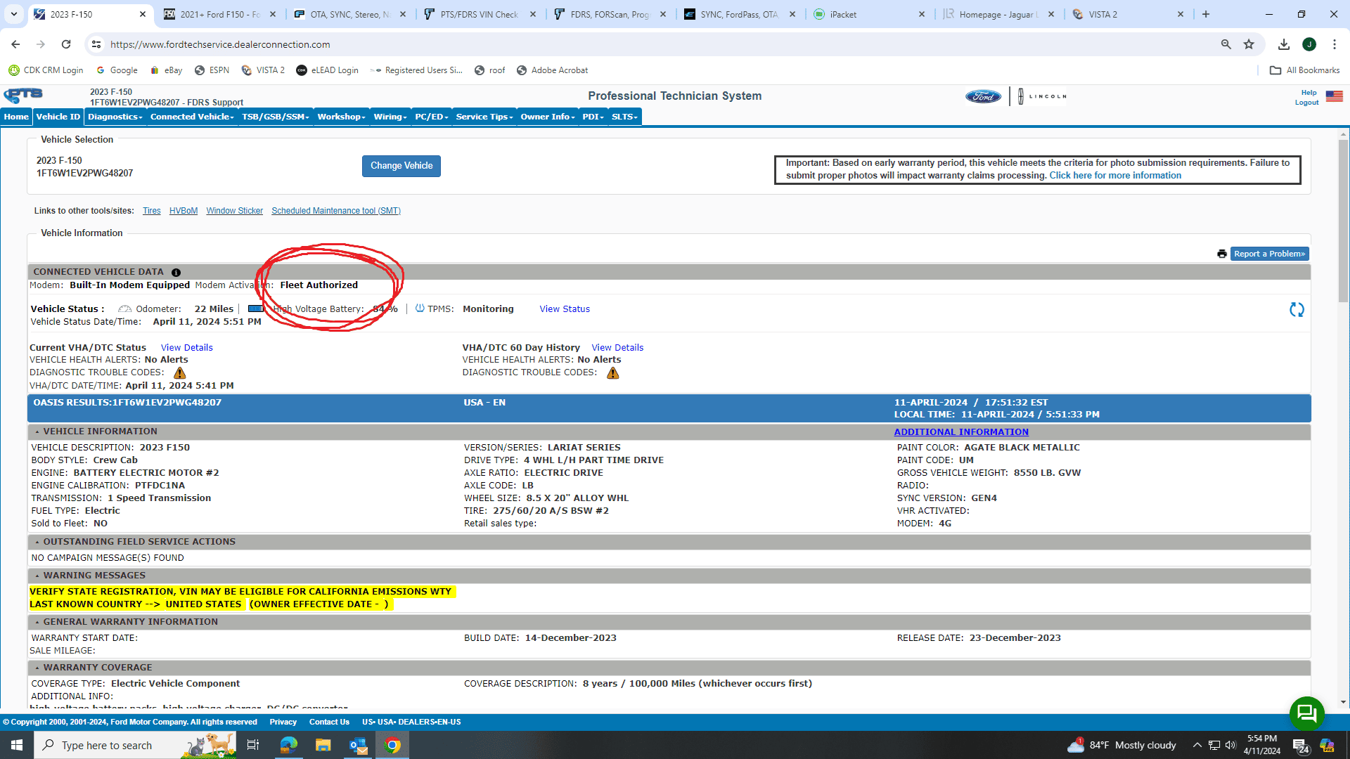

1FT6W1EV2PWG48207
thx in adv!

1FT6W1EV2PWG48207
thx in adv!
I am assuming this is a vehicle you are looking to buy? It does not have a warranty start date yet, but somehow seems to be connected to a Fordpass account already. If you do buy this vehicle, make sure the modem is taken out of fleet mode and switch to retail. The modem being in retail mode will affect the ability for the truck to get updates it needs.

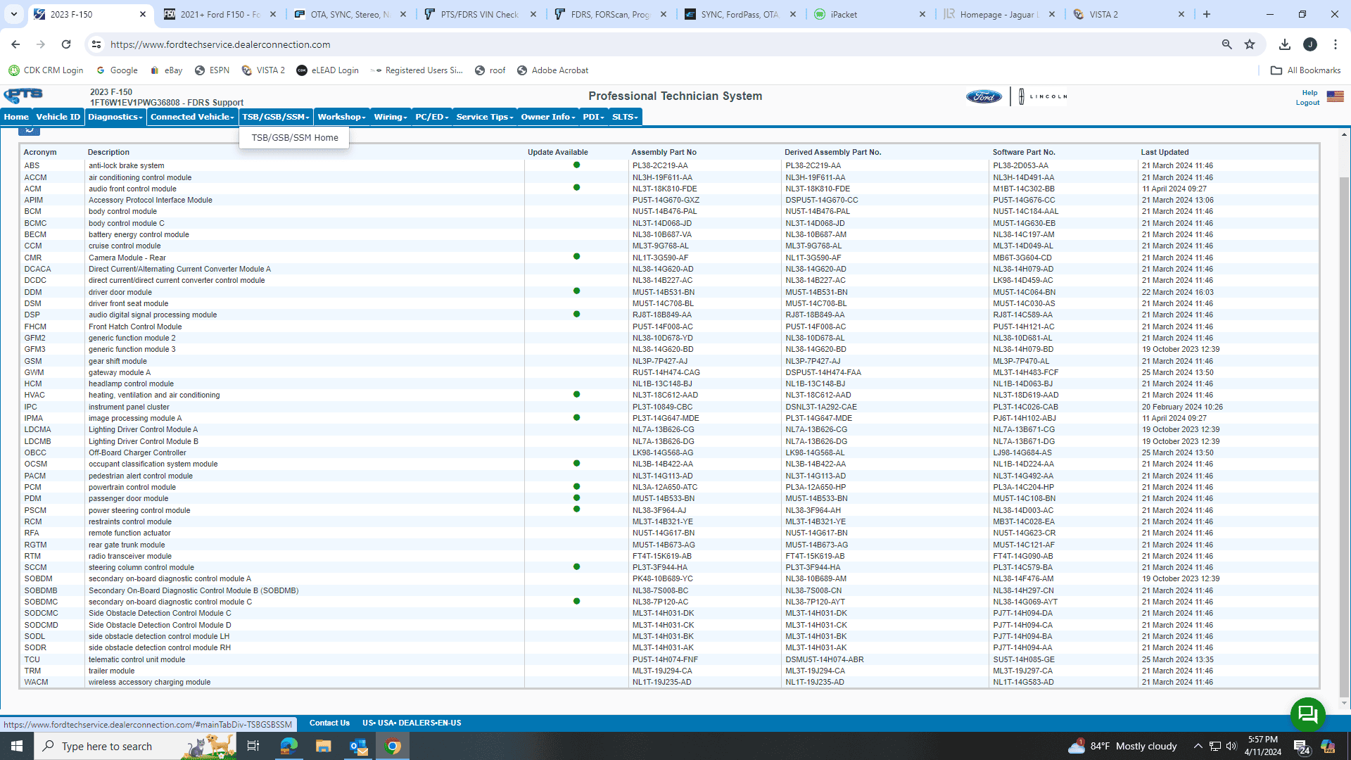

Last power-up update was 6.4.0 followed by the Tesla update and the connectivity update. Modules pending updates are below.
Yes. Looking to buy. Thx so much!
Looks like its getting updates, assuming thats because its in fleet mode. Also is there any way to discern if the 12v battery module replacement csp applies to this vehicle?
Thx
This vehicle has not gotten any updates sent to it, and the fact that the modem is in fleet mode is most likely the reason why.
No open recalls listed in PTS for this truck.

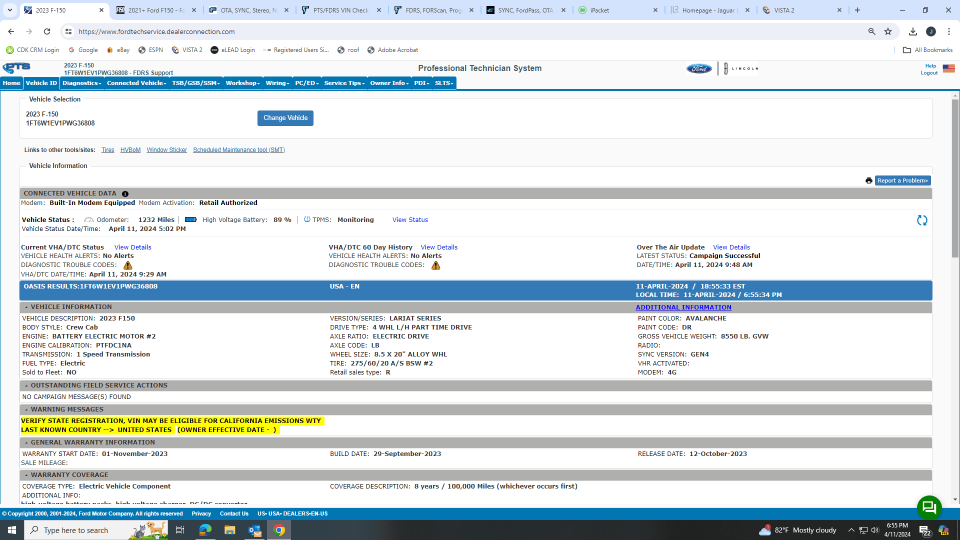

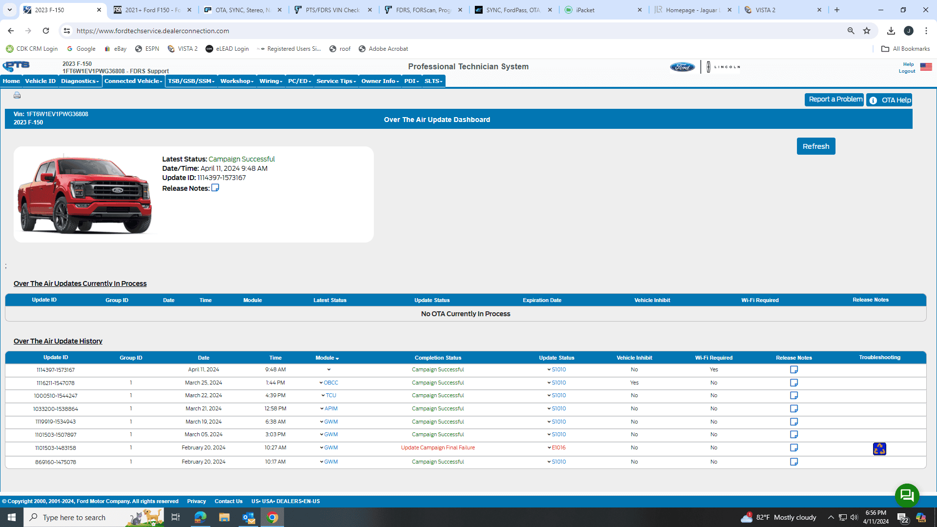

If you get a chance could I get a screen shot of the tabs, Vehicle ID and Connected Vehicle? VIN: 1FT6W1EV1PWG36808. Thanks.
For "connected vehicle", I assume the OTA dashboard is what you want to see as there as more than one option there.

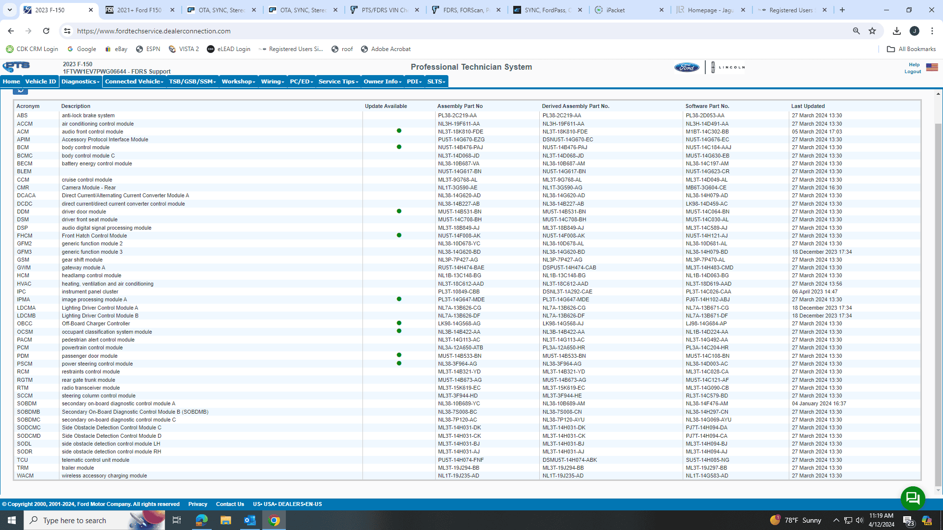

PTS is down and I am unable to pull OTA history, but unofficial list of modules pending updates is below:
