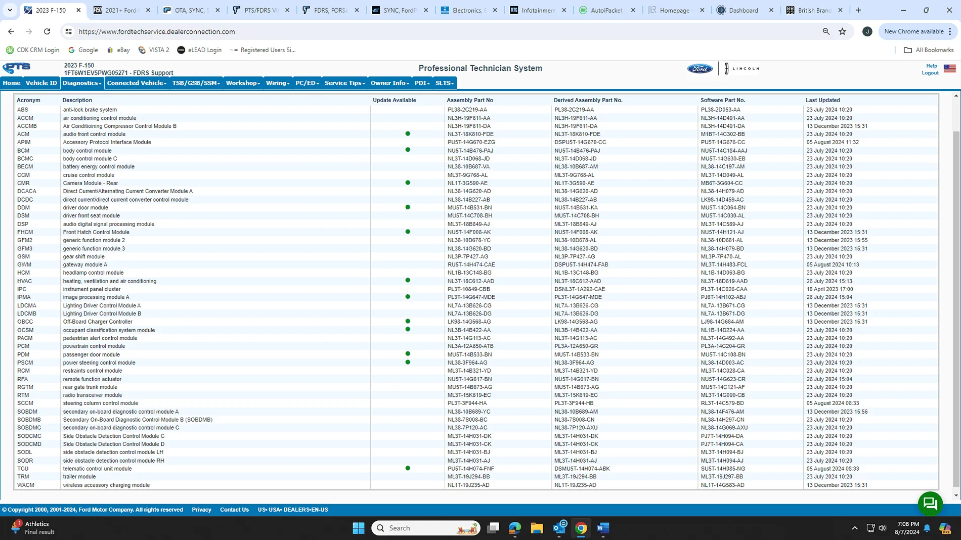

Can I get an update on mine now that some updates were completed?
1FT6W1EV3PWG50077
Only showing a BCM update, but you're not on the latest Sync. Seems like your truck is affected by an issue where the next update you need to fully update the APIM/GWM/TCU modules does not show for you. It is unknown if this is on purpose from Ford's side or if it is due to an issue they need to address.

Hi all,
Was hoping I could get a VIN check on a Ford a Lightning I've only owned for about a month. I was working with Ford and they did have me take it in to the dealer to have Sync updated. it's now on version 4.0.23291. I was told it has no other updates to be applied by the dealer.
VIN: 1FT6W1EV5PWG05271

You are on the latest Sync, but as expected as has happened to 99% of the people who ask dealer to update everything, that was not done. Ford does not pay dealers to do module updates just because they are not up to date and nobody likes to work for free. Dealers only get paid to do updates if there is a recall tied to the update or the update will fix a problem the vehicle has. They did do a GWM and APIM update which got you to the latest Sync version you are now on, but they did not do ALL updates.
Thank you. Hopefully those updates will get dropped for me soon. Thanks again!

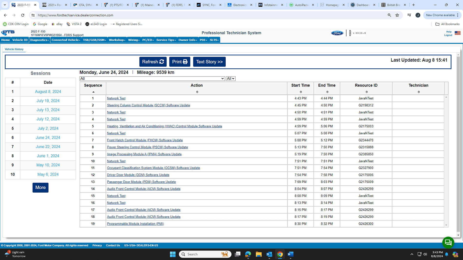

Makes sense! Are you able to see if I did that one myself? I updated so much that I can’t remember what all I did lol.
rugedraw
rugedraw
Javier
Dec 14, 2021
1,897
2,321
Miami
Auto Sales
These are the ones you did. BECM is not there.
