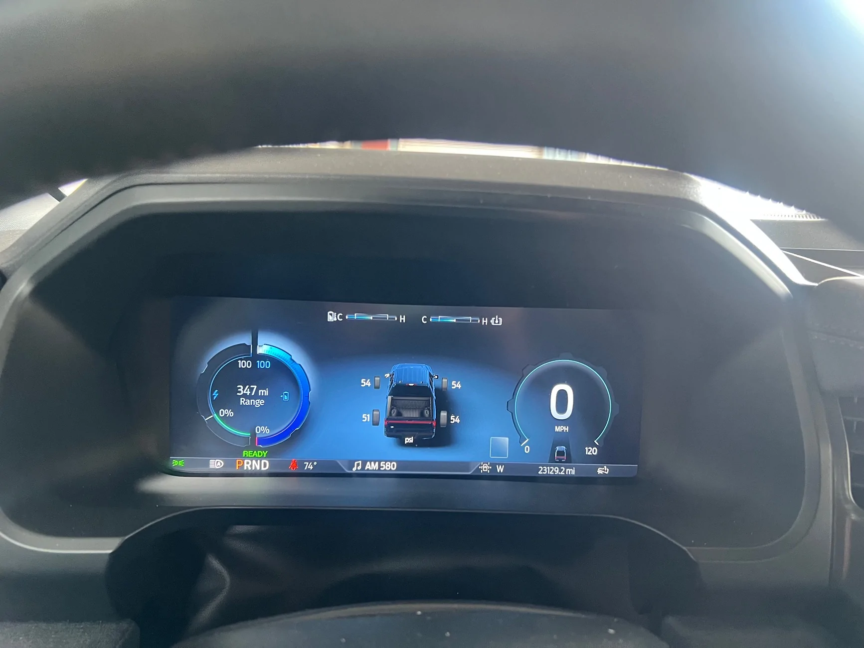

Here’s a screenshot of mine from Sunday morning when I charged it to 100% for the first time in a while just for the hell of it.
Ford F-150 Lightning Range not close to as advertised IMG_8197
Driven about 80% local, 20% hwy.
When on the highway I’m 75-85mph, and when local it’s fairly conservative because local police have no crime to deal with around here and are looking for something to do.
The steering wheel and seat heaters are always on, but the HVAC isn’t doing much this time of year in FL, it’s gorgeous outside!
The front always has a few hundred pounds of tools in it so the rake is more drastic than normal and looks kind of stupid to be honest, but perhaps that factors into hwy range.

Yup, figured you were in the WARM BELT, I'll post my 100% snap shot Sunday evening I expect a less optimistic GOM value for a New England Winter day.

54 psi in your tires! 😳

I try to keep them to 55 on the dash but it was a little chilly out. The TPMS isn’t accurate, 55psi on the dashboard=49psi on my Snap-On mechanical gauge.
