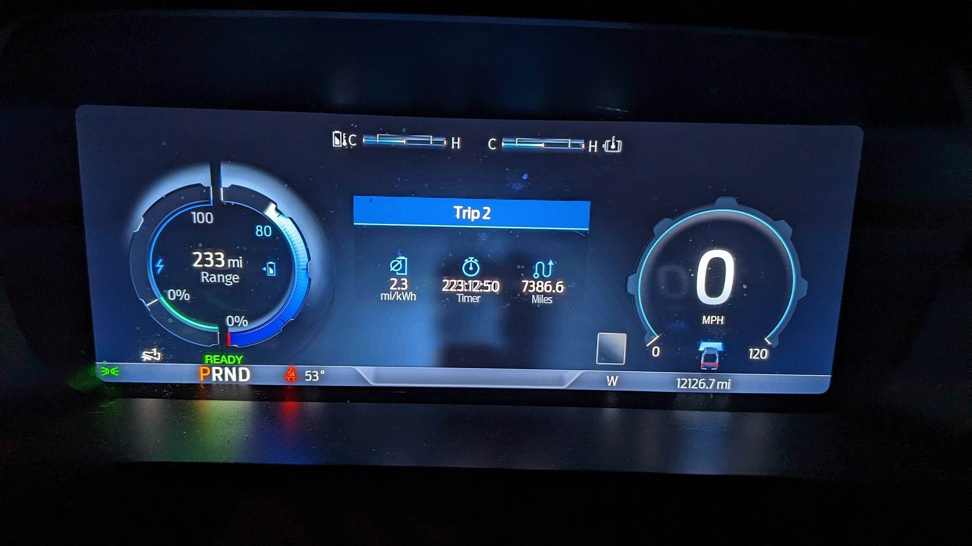

Excellent displayed range.
What is your mi/kwh displayed on your trip meter for the 16,000 miles?
I didn't have a trip counter on from the beginning but have been resetting it twice a year. My driving is 90% local. 10% highway
this from Nov 2023 through mid April 2024
Ford F-150 Lightning Initial range after charge well below advertised range- 2025 Flash trip Nov 1-2023- April 15-2024

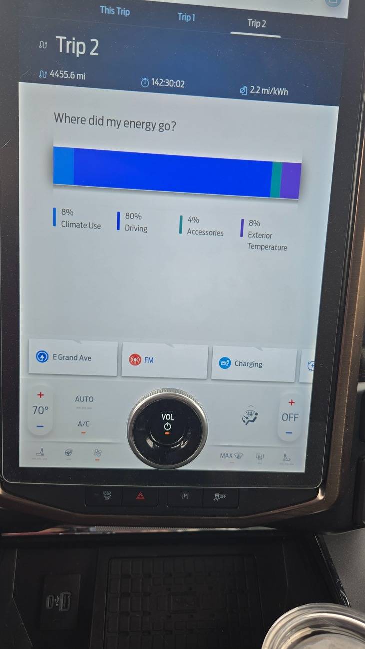

This from apri1 2024 through Nov 2024
Ford F-150 Lightning Initial range after charge well below advertised range- 2025 Flash Trip 2 April 1 - Dec 1  2024

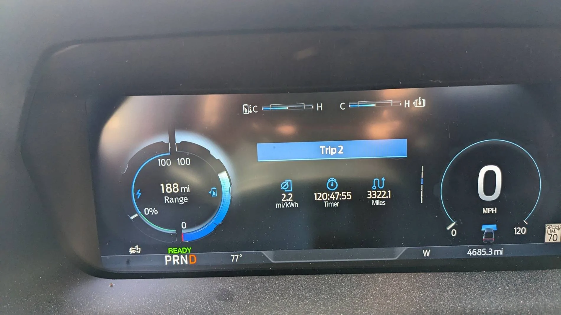

And lastly from Dec 2024 - mid May 2025
Ford F-150 Lightning Initial range after charge well below advertised range- 2025 Flash Nov 1 2024 - May 15,2025 trip log
