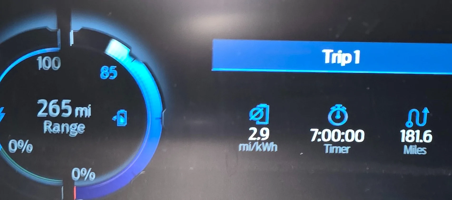

38 one way commute in Texas Hill Country 5x/week. 2.9 mi kwh possible when not using AC, driving speed limit (under 55 most of the way), 1 pedal Normal or Cruise control 70%. 25' Flash Build 1 133kwh
Ford F-150 Lightning Initial range after charge well below advertised range- 2025 Flash 20251121_184922

Wow. I'd like to see more lightning readings like this.

25.8571 MPH, was the truck idling for an extended period?

If you want to know what you should be getting, reset one of your Trip logs (I use Trip 1) and drive for a week. Take the efficiency number (miles per kWh) after your week of typical driving and multiply it by 131. That's your typical driving range for the weather/terrain.
If you average 2.0mpk, that's ~260 miles. You need 2.4ish to achieve the EPA rating.
I just wanted to support this. The reported energy usage is accurate, not a guess, so if you drive around at a leisurely pace, you will probably find that you can get 2.4 or 2.5 miles per kWh. If you repeat that a few times, you should get a better indication from the GOM. If you are still getting low range, but are generally driving at 2.4, then you should have the battery checked.
