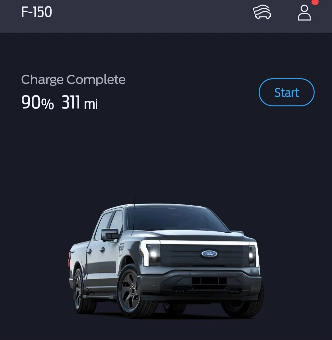

Hello
I just purchased a used 2024 lariat with 10k miles on it. It’s at 91% charge and only shows 236 miles of range. Is that normal and are there settings I should change to optimize the range. I don’t expect the full 320 but thought it would be much higher then where it is at now. Thanks!
No, summer months should show a higher range estimate. I just finished charging at home. I charged to 90 percent, and it shows and estimated range of 311 miles. The estimate is pretty accurate to what I am actually getting.

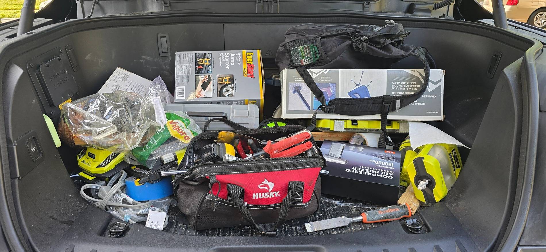

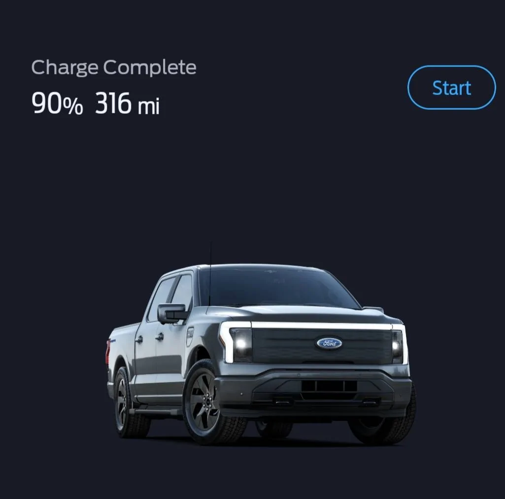

Hello
Your driving habits will make all the difference in the world. My estimated range charging at home is great during the summer ☀ months. At home, I charge to 90 percent, and the estimated range goes as high as 316 miles. I don't exceed 70 MPH. I even drive around with junk in the frunk.
Yep, you do have some stuff in the frunk! :wink:
Looks like a lil bit of everything....
