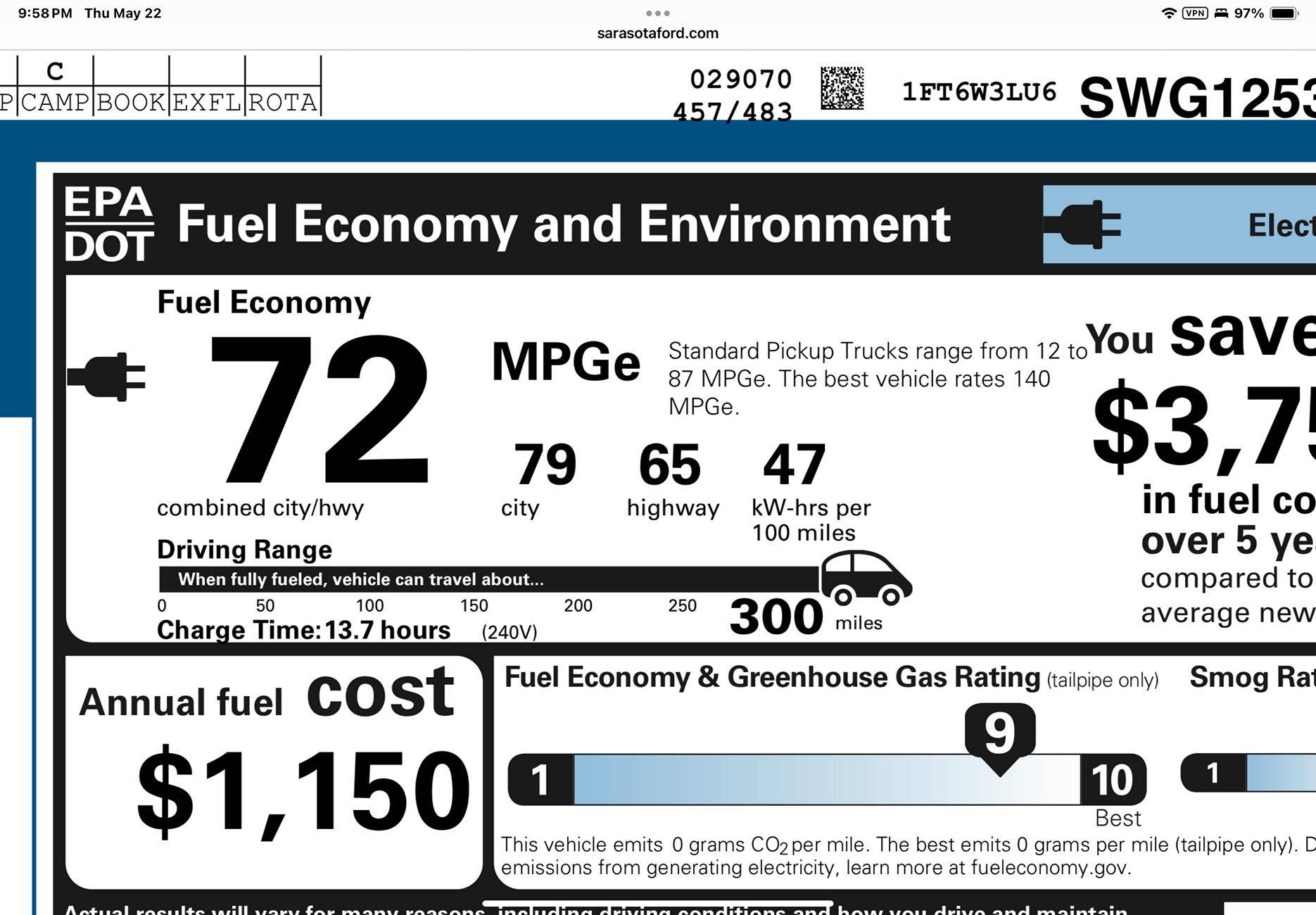

You ARE GETTING THE ADVERTISED RANGE.
Efficiency of an internal combustion engine (ICE) vehicle vs an EV is opposite. ICE vehicles are more efficient when driven on the highway than city driving. EVs are opposite, they are much more efficient at city driving than highway driving.
Look at your window sticker. Combined range for city/highway is estimated at 300 miles (not 300-320)
You stated mostly highway driving at 70 MPH.
Highway Economy is 90% of combined Economy per window sticker (65 MPGe vs 72 MPGe) So if combined Range is 300 miles then advertised range for highway driving is 90% or 270 miles.

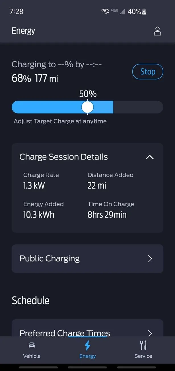

If it's a '25 Flash it may well have the 123 KWA battery. If so, my '25 acts exactly the same. If the drive style learning has an effect, and i think it does, about 1/2 of my driving has been at hiway speeds getting 2.0 or less mi per KWH. Around town it does a good bit better.
If the EPA rating is 300mi, it's the 123KWH battery.
Do the math below and you get about 260 miles.

Yes, recently discovered that I do have the 123 jaw battery- so that explains a lot.
