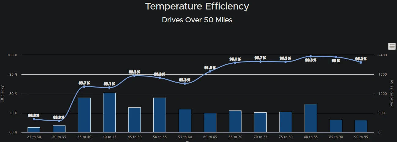

Does preconditioning heat the battery as well as the cabin?
I hope Ford does not nerf the regen in cold temperatures the way Tesla does. When the battery is below 67F, regen is reduced. This affects range when in stop and go traffic and you lose 1-pedal driving since the vehicle just sails ahead and free wheels. I park my Model S in the garage, but the F150 won't come close to fitting so it will be colder more often.
As others have said, cold range isn't a big deal for short trips, mostly longer ones. For reference, this is a temperature graph of efficiency (percentage of EPA rated range) on my 2015 Model S:

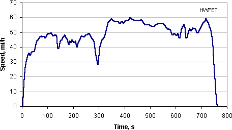

So yes, the Lightning will have a larger aero effect than the Mach-E but this this is accounted for in the EPA highway rating
This is not "accounted" for when you start increasing speed. It's accounted for based on same test cycles. In other words, the EPA ratings don't scale / provide a dynamic range based on speed -- it has two numbers City and Highway.
The highway range tests for EPA cycles are not fast. This is the highway cycle ford likely using:
Ford F-150 Lightning Read before you order! Expect 50% range loss in winter in Northern states. hwfet
It barely goes 60mph, average speed is 48mph.
on 2-cycle (which ford used for Mach-e, so I assume the F150L), the highway range is determined by whatever they got on the highway cycle times .7 (to get a more realistic number).
2-cycle tests are not very accurate. Plus all EPA ratings take into account charging losses, so they are really guestimates. The longer 5-cycle test is more accurate (which bumps up speed and uses AC and other more real world conditions).
Driving faster in a bigger/heavier car will cause greater energy looses compared to a smaller car.
