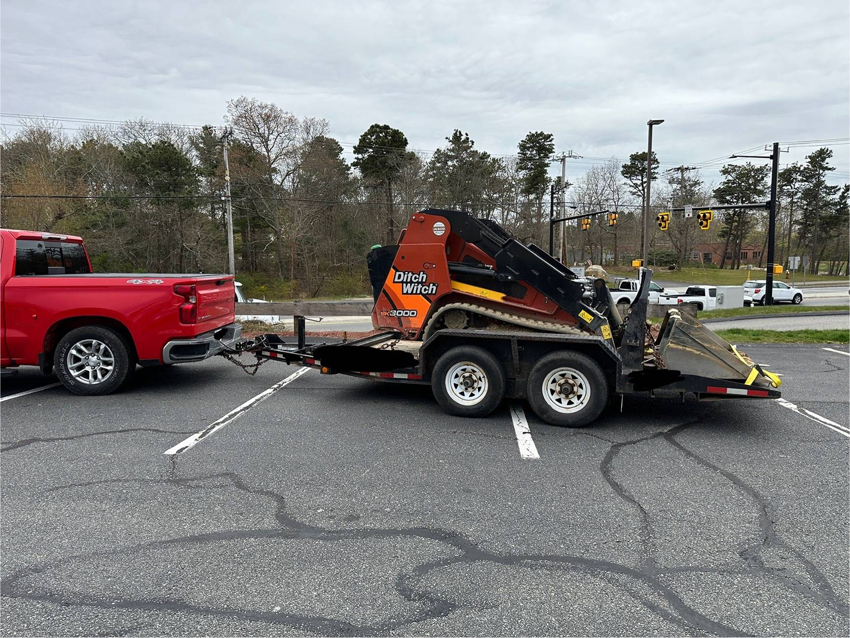

I just ran across this pic in my phone. My last work setup was running pintle on a long bar, the center of the pintle hook was about 8” from the bumper. It towed fine, but really squatted the truck. I believe Chevy has the same recommendation for the weight distribution over 1/2 of the capacity, but in four years of work and thousands of miles towing up to +/- 10,000 pounds it never caused issues. The machine in the pic is 7600 pounds plus attachments and the trailer is 2600 pounds rated for 12K. I believe rated tow capacity for that truck was 11,600 pounds, so this load was close to the max.
Ford F-150 Lightning Receiver Hitch Recommendation? IMG_8133
