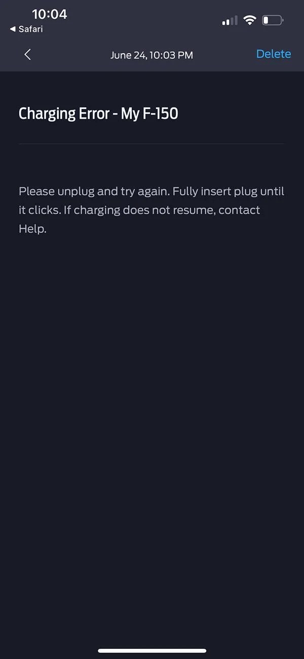

Receiving charging error on my FordPro charger.
matthew.theoret34
matt
Apr 3, 2025
2022 Ford lightning Lariat - Extended range
Receiving charging error from my FordPro charger.
it happens just about every time. Someone’s it will start up again.
Other times it will stop charging.
I reset the breaker and plug it back in and will start to charge again.
Not ideal as I plug it in overnight for my shift in the morning.
Charger shows a solid yellow light on the right side of the charger light bar.
Any advice?
Charger is from 2023
