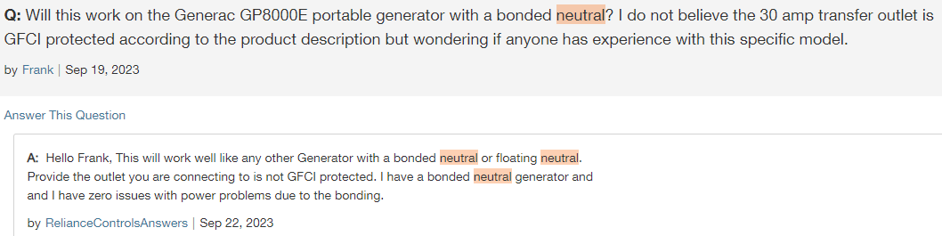

I haven't been able to keep track of all the neutral/bonded/gounded chatter to know if this means it's good or not. Posting so more knowledgeable folk can chime in.
Ford F-150 Lightning Reliance Panel transfer switch 1725460933312-hh

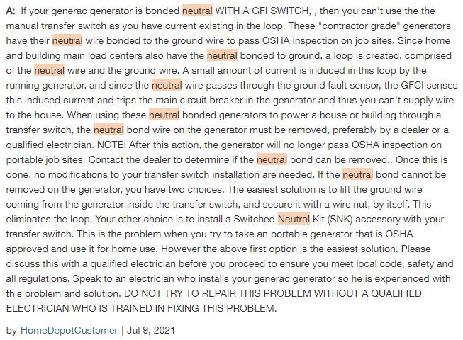

EDIT: There's another Q&A later that says a Switching Neutral Kit is needed, pretty certain this applies to our trucks:
Ford F-150 Lightning Reliance Panel transfer switch 1725461502516-kl
