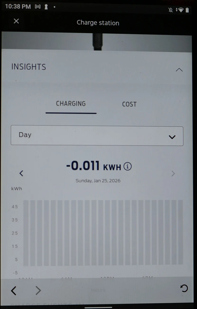

Besides the Ford app fault messages, one time, my FCSP reported that I had added NEGATIVE energy to the truck. For the antimatter flux capacitor maybe?
Ford F-150 Lightning Repeat Charging Errors IMG_6039

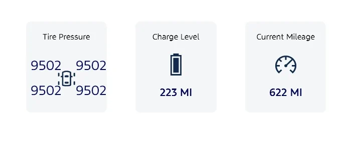

And right now, the Ford app and the truck are reporting on tire has 35psi and the others 36psi - my digital pressure gauge says they are all the same 36psi, so I am ignoring it.
One time the app told me my tire pressures were over 1000psi...
Ford F-150 Lightning Repeat Charging Errors tire pressure - OMG
