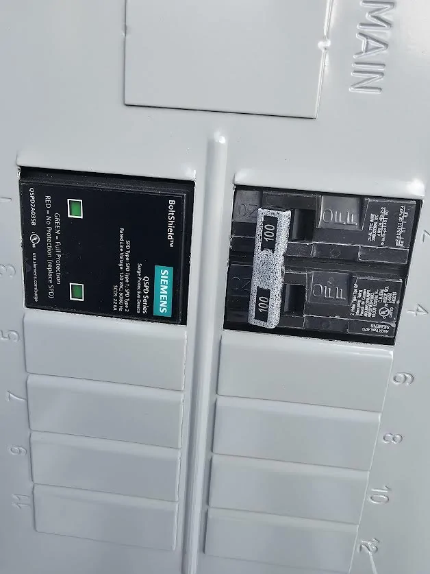

I posted a few weeks back how I'd had my truck in for a heater replacement, charged it at home and the breaker at the meter tripped. Here is the setup. Isolated meter from utility in back of house, used exclusively for truck. it has its own breaker > wiring from this to box in front of house > surge protector(imaged), in front box > 100amp meter(imaged) in front box > fcsp set to 64 amps.

-The meter breaker tripped, while the fcsp's breaker (imaged) stayed in the on position. (could a 64a setting gone wrong fail to trip a 100a breaker??) Nobody seems to know exactly why the box breaker won't trip but the meter breaker will.
-the box breaker (imaged) has very weird white coloring on it that an electrician forum said indicated water ingress / condensation on the zinc plated bar

I suspect the biggest clue of all is the old breaker (imaged). that there may indeed be corrosion and faulty happenings with the zinc bus bar. though the electricians had their tools out and were testing everything. when they first turned on the new fscp, they watched the amperage climb up to just below 80 amps. when they turned it to 64 amps, they watched the amperage climb up to around 60 amps. they were satisfied, everything looked good. now they will have to come back, and more money will be spent. if anyone can provide me some very good chores, checklists, things to make sure they do before they leave this time, it would be much appreciated. if it is a corrosion issue due to moisture or temp differential (sweat) can my outdoor box be upgraded/insulated/heated so it can not do that again the next time we hit sub-zero weather?!

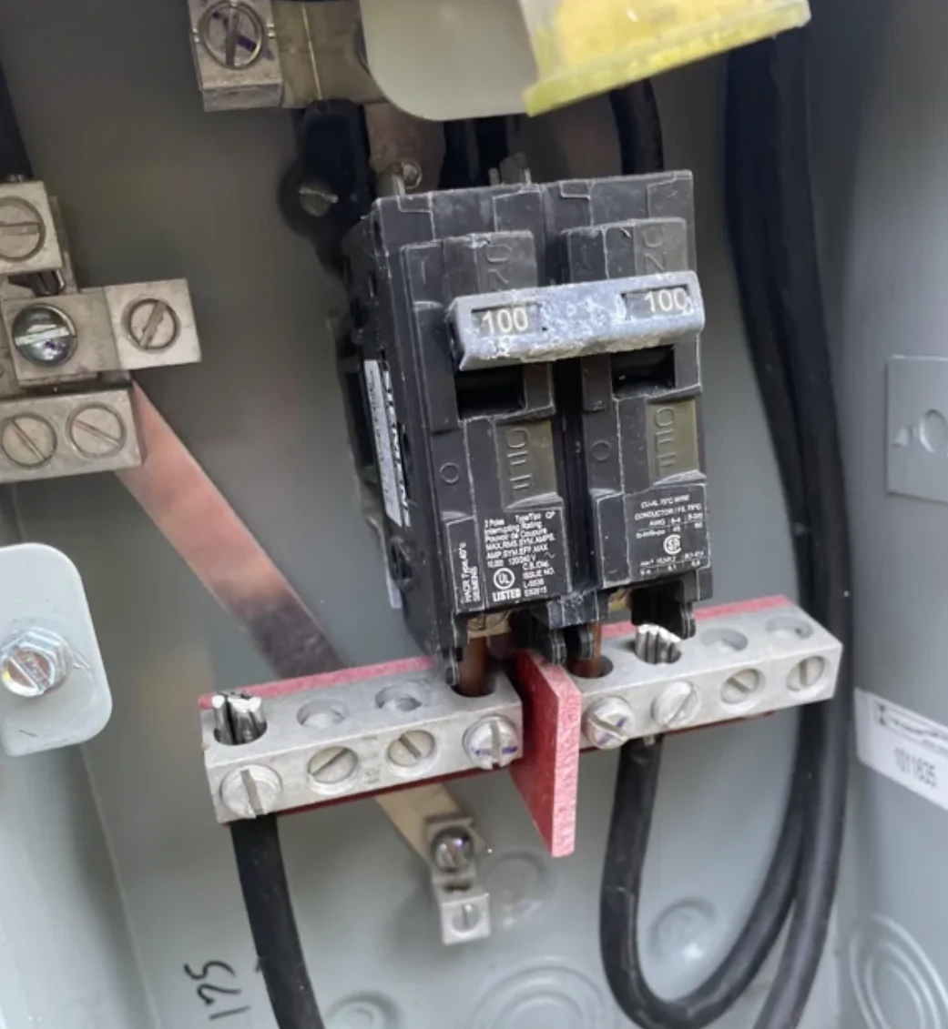

Saw another Siemens QP where the metal tie bar looks to have same corrosion as yours.
Interior looked normal.

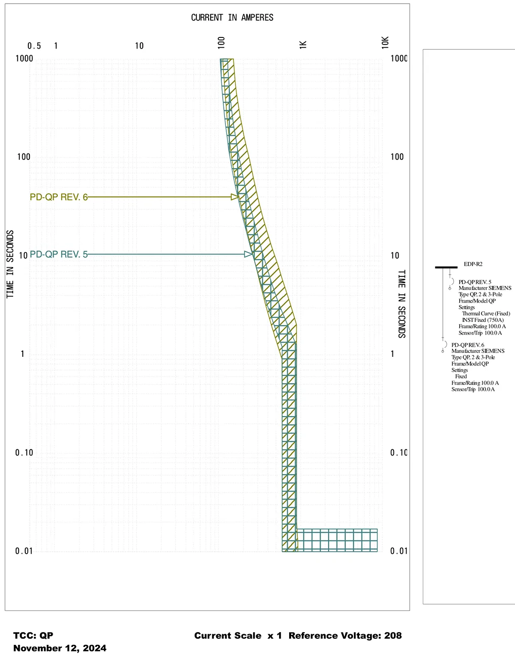

Since you weren't charging above 80A originally, don't know what would have caused the trip.
For the original 100A CB a sustained over 100A would trip it in about 1000 seconds / 16 minutes per MCB circuit breaker time current curve. https://forums.mikeholt.com/threads/tcc-curve-for-circuit-breaker.2584218/post-2958014
Ford F-150 Lightning Replaced Charging Station, tripped meter breaker again. 1776811003731-an

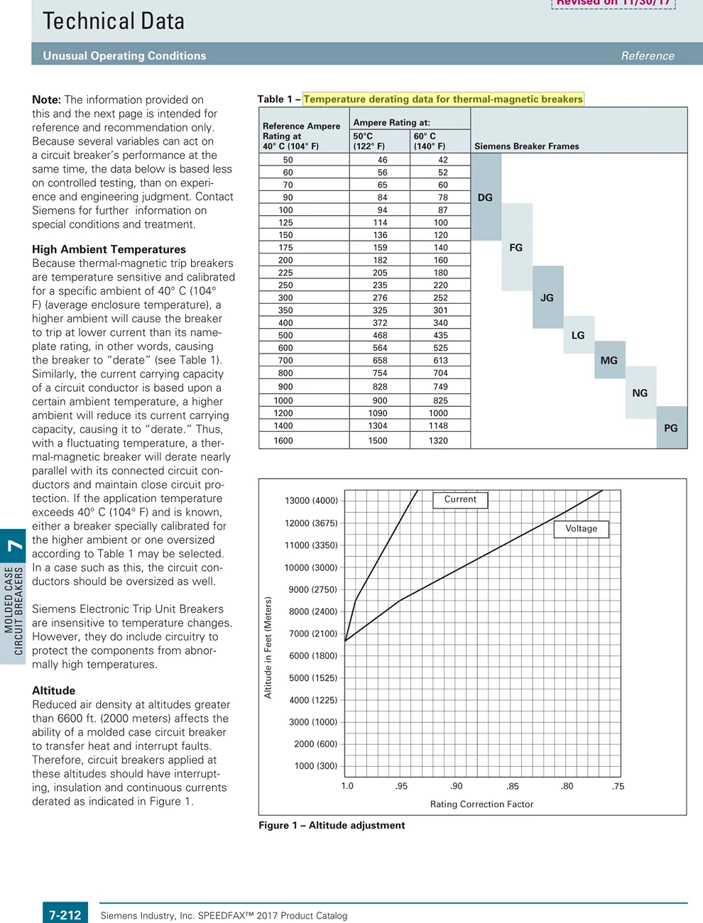

High ambient temperatures are what are usually mentioned in mfgrs. info, not extreme cold.

I would agree with your electrician that the breaker looks like it got wet. You can also see similar white indication on the black wires below the breaker in your 2nd photo.
It's a little confusing what we're looking at from your description. You have two boxes each with a 100 amp breaker. The photos both show the white "damage" on the breakers, but appear to be the two different boxes. Can you confirm what photo is what and in what order these are (i.e. which one is downstream of the other)?
The OP only provided 1 photo.
Oops - my error. Did not notice that the second photo was from someone else. Guess that's what I get for scrolling / reading too fast...
