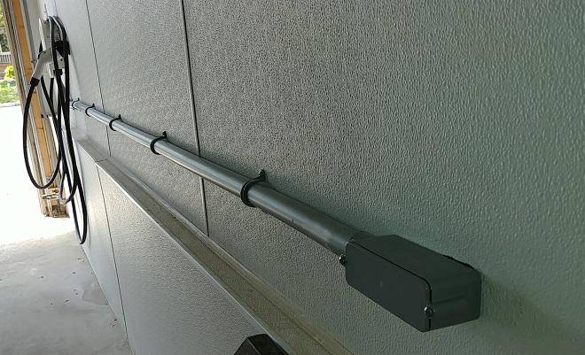

The proposed receptacle location inside my garage is literally back to back with my service box.
That definately makes the conduit a reasonable option.
In our case, the panel was on the other side of the wall from the garage in the basement, but about 8' further in the garage than where the EVSE was to be located.
When I got my Focus Electric almost seven years ago, I installed its EVSE on the south (right) side of the garage near the door. This was so it could reach when the car was in the garage or outside. That wall was unfinished and there's a sub panel on that side at the back that serves the garage and all outside outlets.
For the Lightning, parking in the garage is not an option, but the EVSE was to be located opposite the other on the north (left) side. The location of the main panel was ideal for this:
