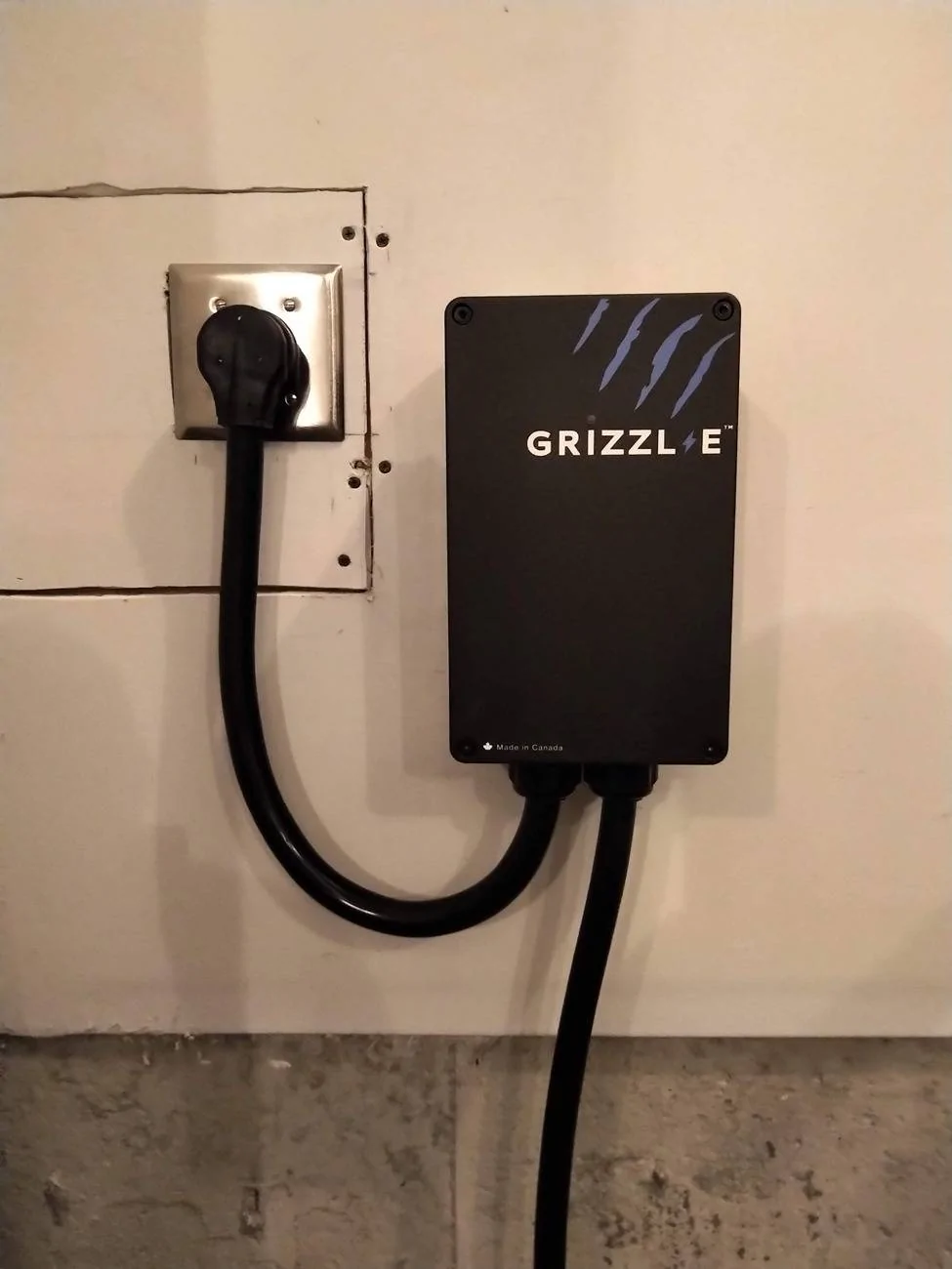

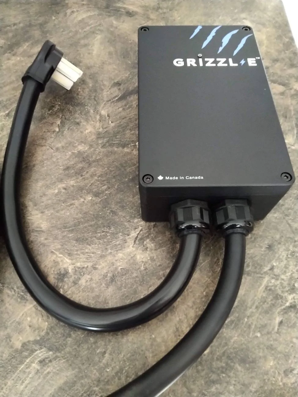

I've had good luck with the Grizzl-e $400 on amazon
I have the same charger. It comes with a standard 3 year warrantee. You can order it with a 14-50 plug from amazon and then plug it into the 14-50R receptacle you are planning on using. The Grizzl-e charger will come set up to draw 40 amps, but you can select different amperage settings by changing the dip switch's inside on the circuit board. I recommend running 6 gauge COPPER wire for the 2 hots and neutral and an 8 gauge COPPER wire for the ground. You should also use a 50 amp breaker for this circuit as 60 amp breaker is to big. You will then be set to charge with either the Grizzl-e charger or the Ford mobile charger at your home, as they both have a 14-50 plug on them. You can also take the ford mobile charger with you when you are out of town.

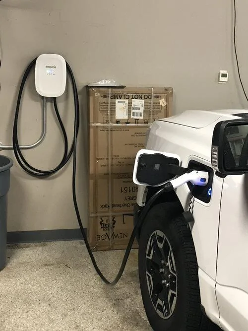

I have the Emporia. Works great.
Except, skip installing the flimsy holster bracket. Just loop the cord over the top to hang it. The enclosure actually seems to be designed for this.
