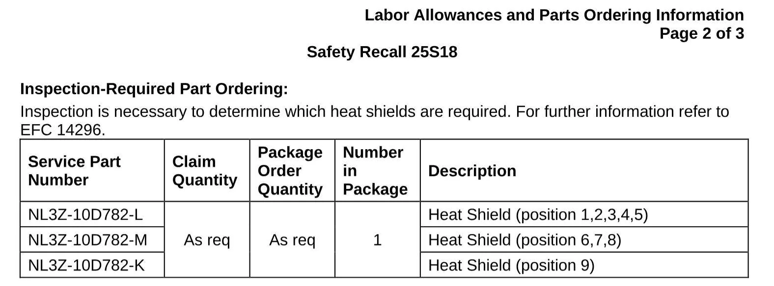

I would recommend you print the notice and take it in to the dealer.
Order and receive modules/battery by specific VIN by contacting the Ford Special Service Support Center (SSSC) prior to the service appointment. Additional materials such as heat shields will require inspection of the opened battery prior to ordering.

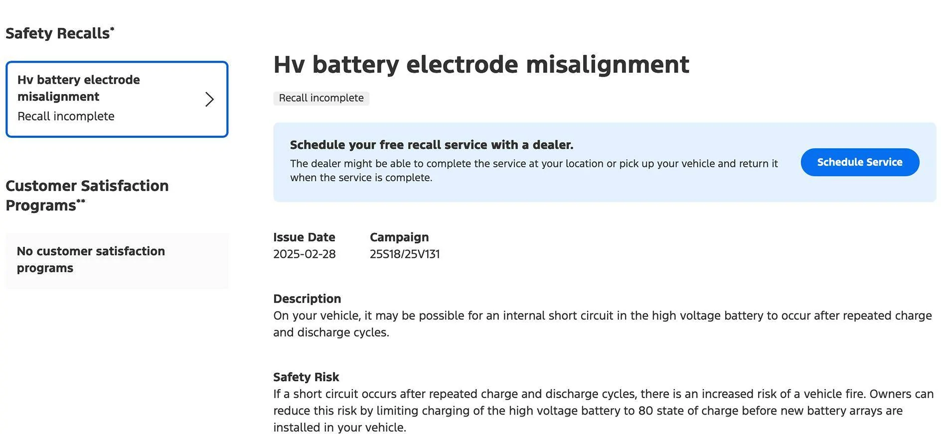

There was a period awhile back that certain modules were in short supply. It is good they are allowing you to use the truck, many folks over the last couple of years have reported their truck sat at the dealer for weeks waiting for a module. I am confused, however, with this statement and your title of Electrode Misalignment.
Is this the language on the work order?
Just got the invite last Friday that modules are in stock and to schedule an appointment with my local dealer. Truck is in the shop right now and modules are being tested.
