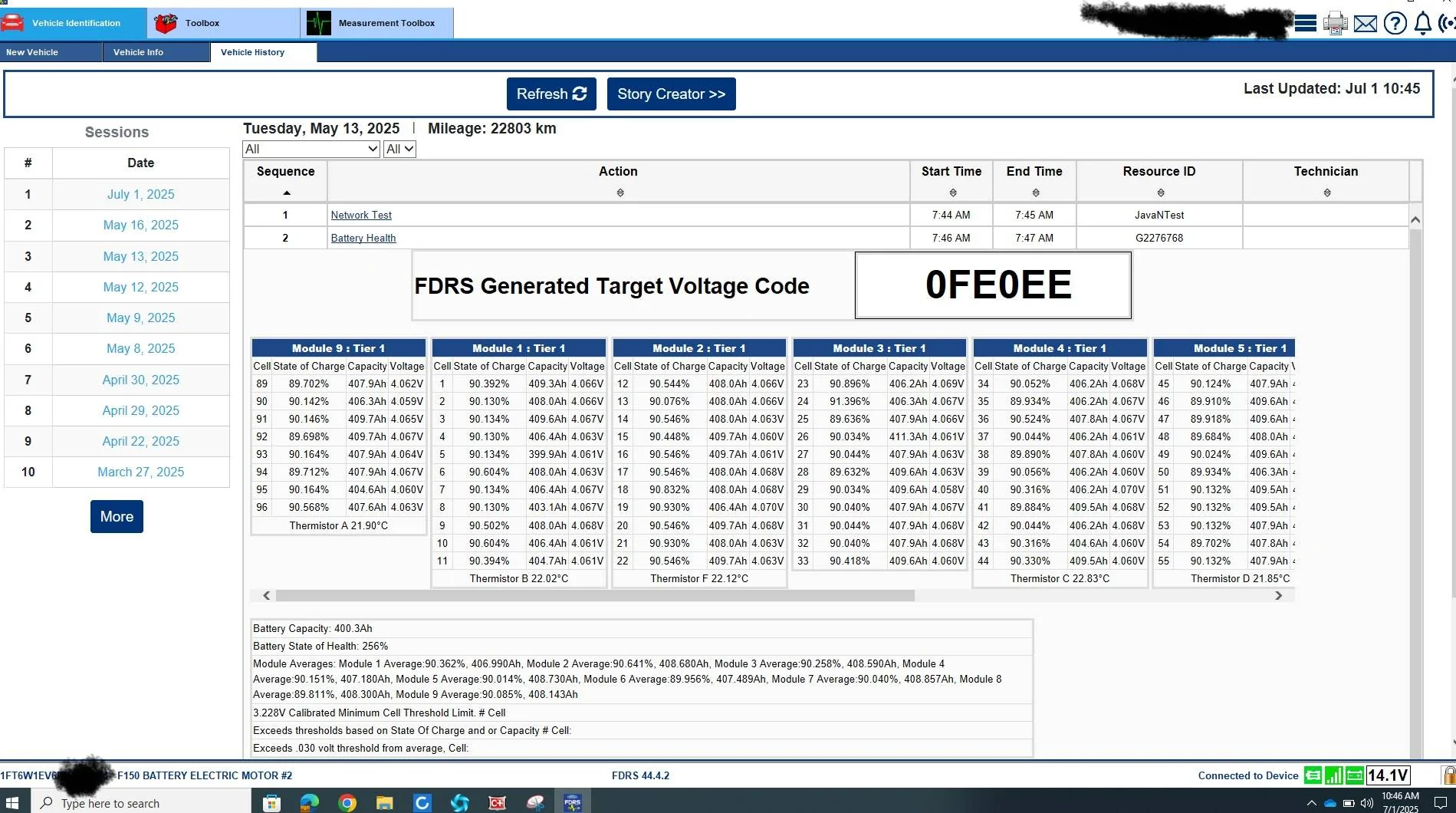

Question: Do warnings / alerts such as "powertrain malfunction" show up on an OBD scan? If these alerts are triggered, how do they 'go away'.
Ted23Lightning
Ted
Mar 25, 2025
278
234
Mobile ADAS Technician
ALL
So this response is kinda broad, just because I’m not actually at the vehicle. But if an error message populates in ur instrument cluster a DTC should also populate.
Even if the error visually goes away on the dash, a history DTC should be present.
When you scan the vehicle, you can sometimes clear the DTC depending upon which module it’s in, and if the vehicle is running (it shouldn’t be). But even if you “clear it” doesn’t mean that it’s fixed or calibrated.

Update:
selling dealership is basically saying they did nothing wrong, and there was no way they could have identified any issues.
complete BS. The truck has sand in the frame, and they apparently never did a diagnostic scan. Or they did, knew about the issues and sold it anyways. Either way it’s insane that they would claim this.
234
16,628
18,779
Are you implying flood damage to battery pack???
