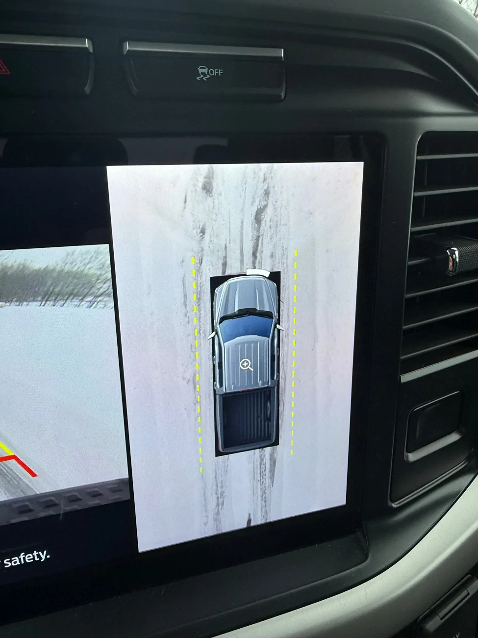

I get the same thing. Tried to explain to the dealer last time I was in for another issue. They didn’t check into it at all. Always the same sensor. Always when cold or warm and raining.
There was a CSP for the issue I tried to tell them about but they didn’t check into that either.
The picture is of me having just pulled out of the garage. Nothing physically on the sensor. Truck was clean.
