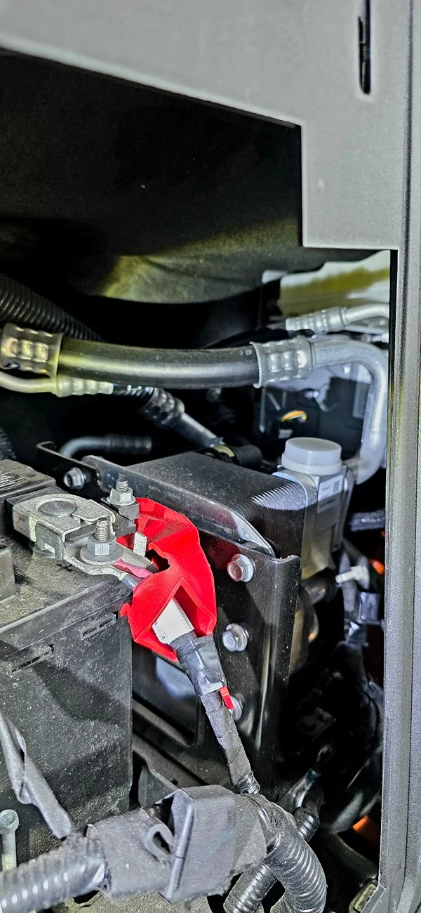

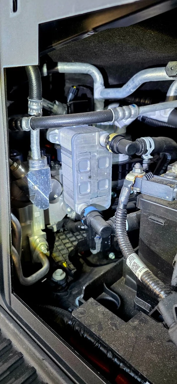

Anyone else considering a pre-emptive swap out of the coolant valve BEFORE it gets stuck, while you're 300 miles from home...the "known problem" part gets my attention, as does the $100 part.
For those of us with a shop, tools, lift, time - why wouldn't we plan this sooner than later?
I went out and decided to look deeper into the rabbit hole on my truck and I don't see that valve, I think it has something to do with the new heat pump system late models come with. Couple pics for ref, right and left side of lvb, it would seem the coolant flows into an aluminum heat exchanger of some sort in the 2nd pic.
Excellent news !!
(one less thing to be worried about)
