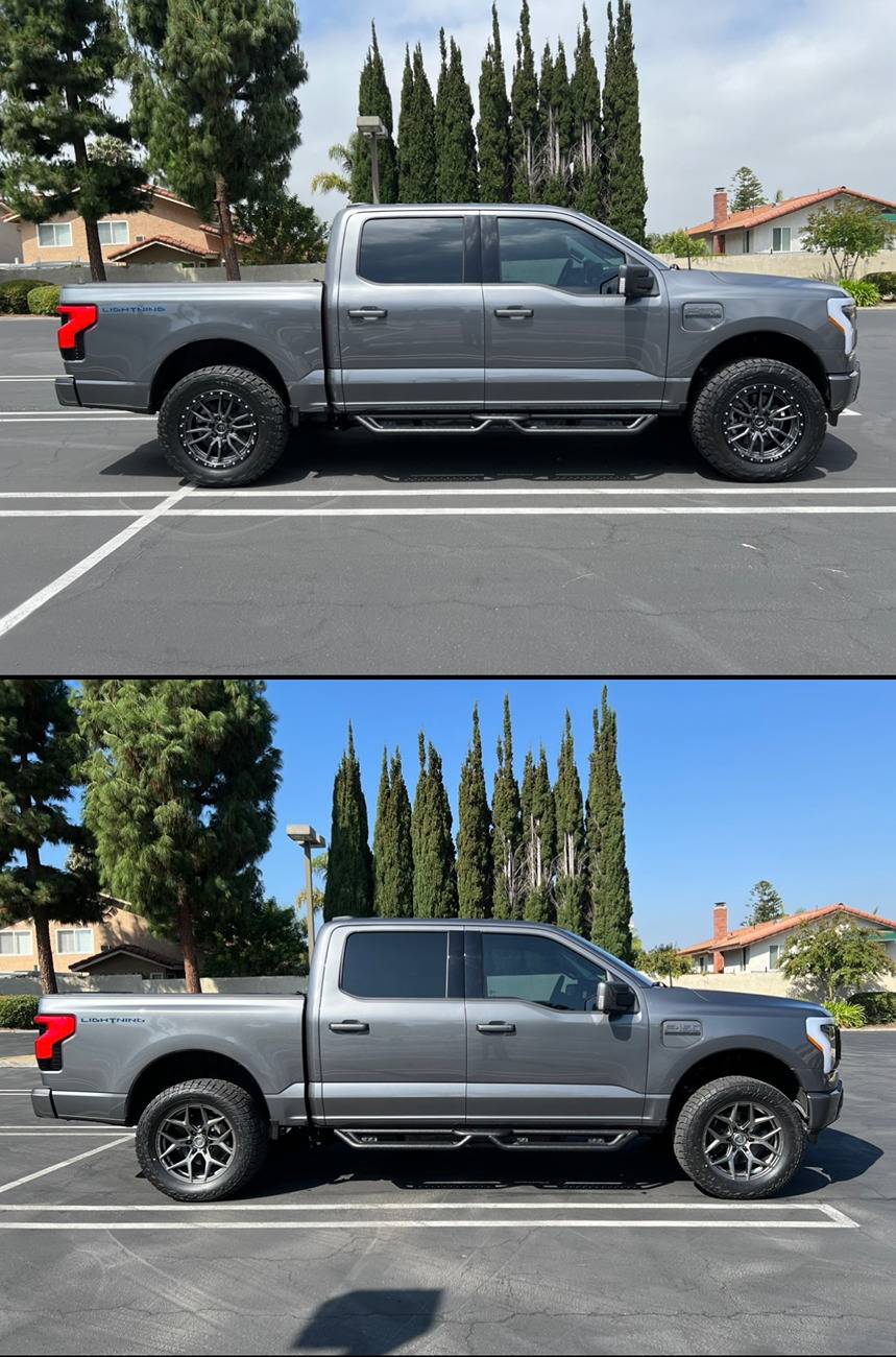

OK so I pulled the trigger and put 305/55R20 SL rated Falken Wildpeaks on. I spent days going down the rabbit hole looking at wheel sizes, tire sizes, etc. I wish there were more SL rated tires in the bigger sizes but oh well. The ride is noticeably smoother. Even though the tire height difference is only 0.7" for some reason the truck feels like it sits lower. While I was at it, I opted to get new wheels too, went with Venomrex VR601s. These have a +12 offset, so the combination of the slightly wider tire and the slightly less positive offset (my Fuel Rebels were +20) give about 0.5" more poke. My first reaction is that the 34's look better. But I am giving it time and the 33's are growing on me. I like that the 33s are a little wider. I'll drive a bit more with these and then decide if I keep this setup.
Ford F-150 Lightning Soften up my ride... IMG_1469
