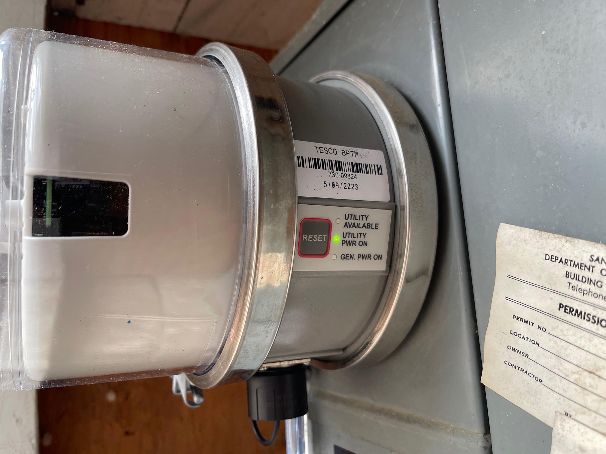

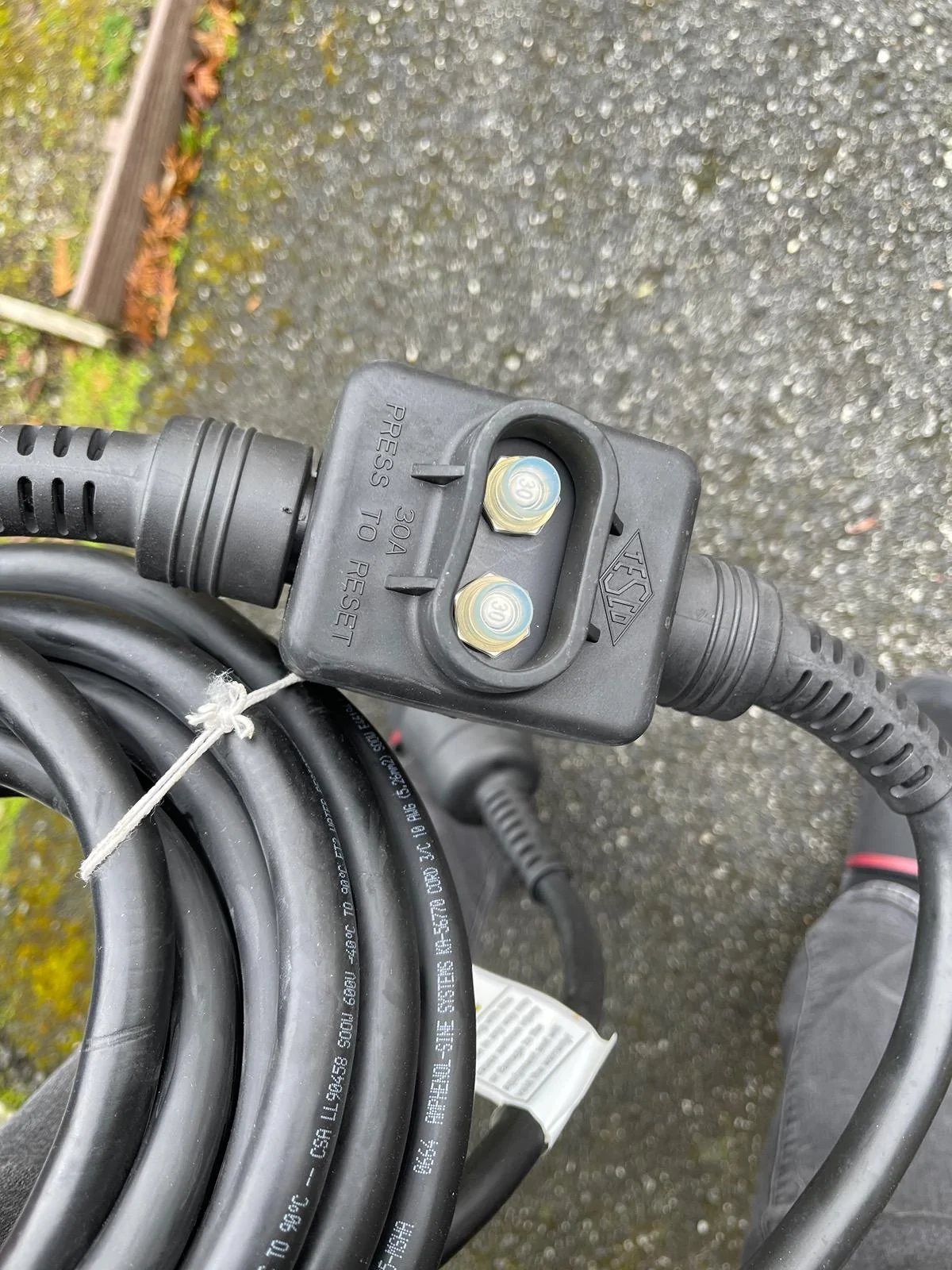

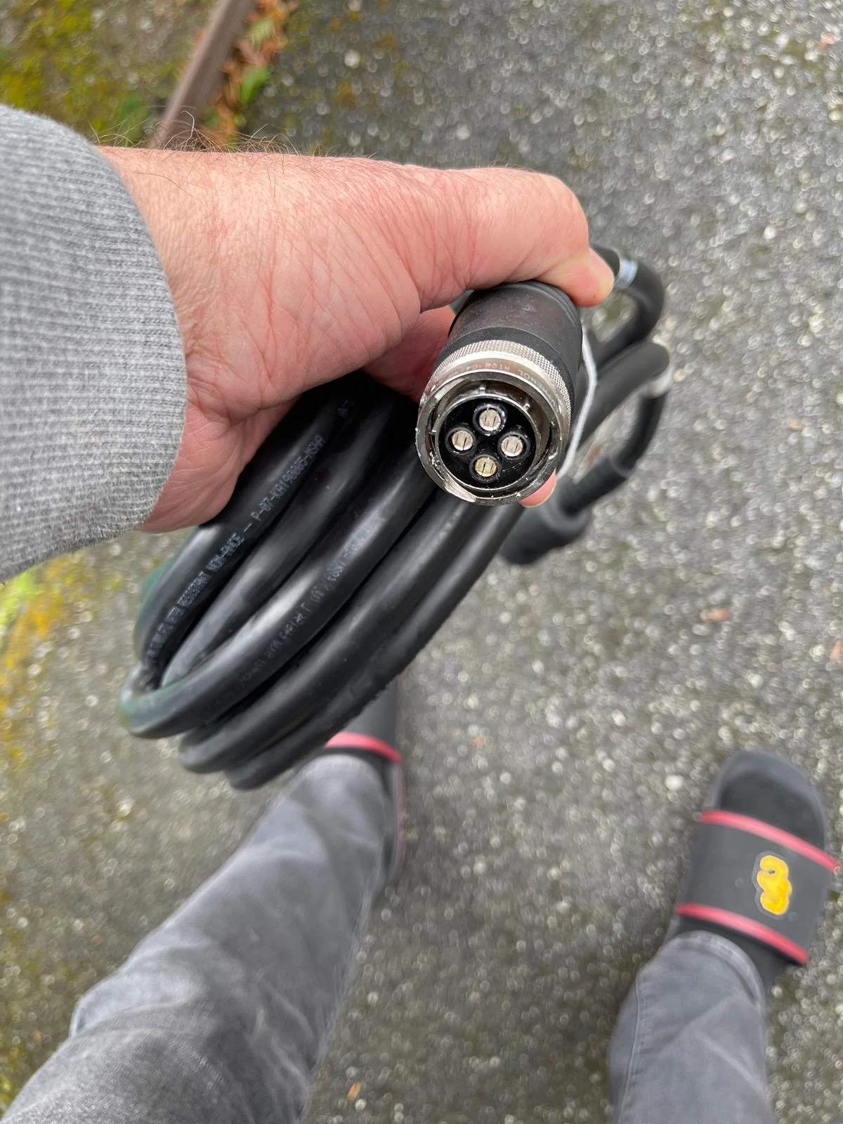

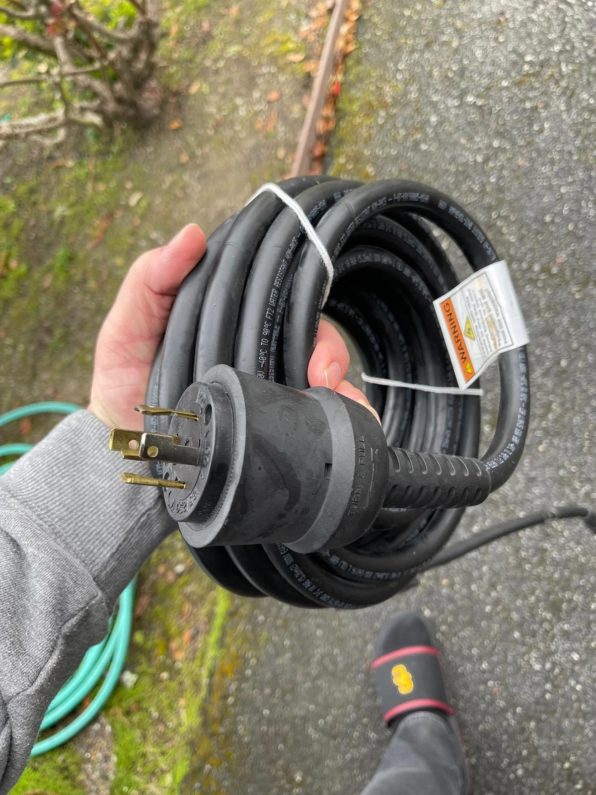

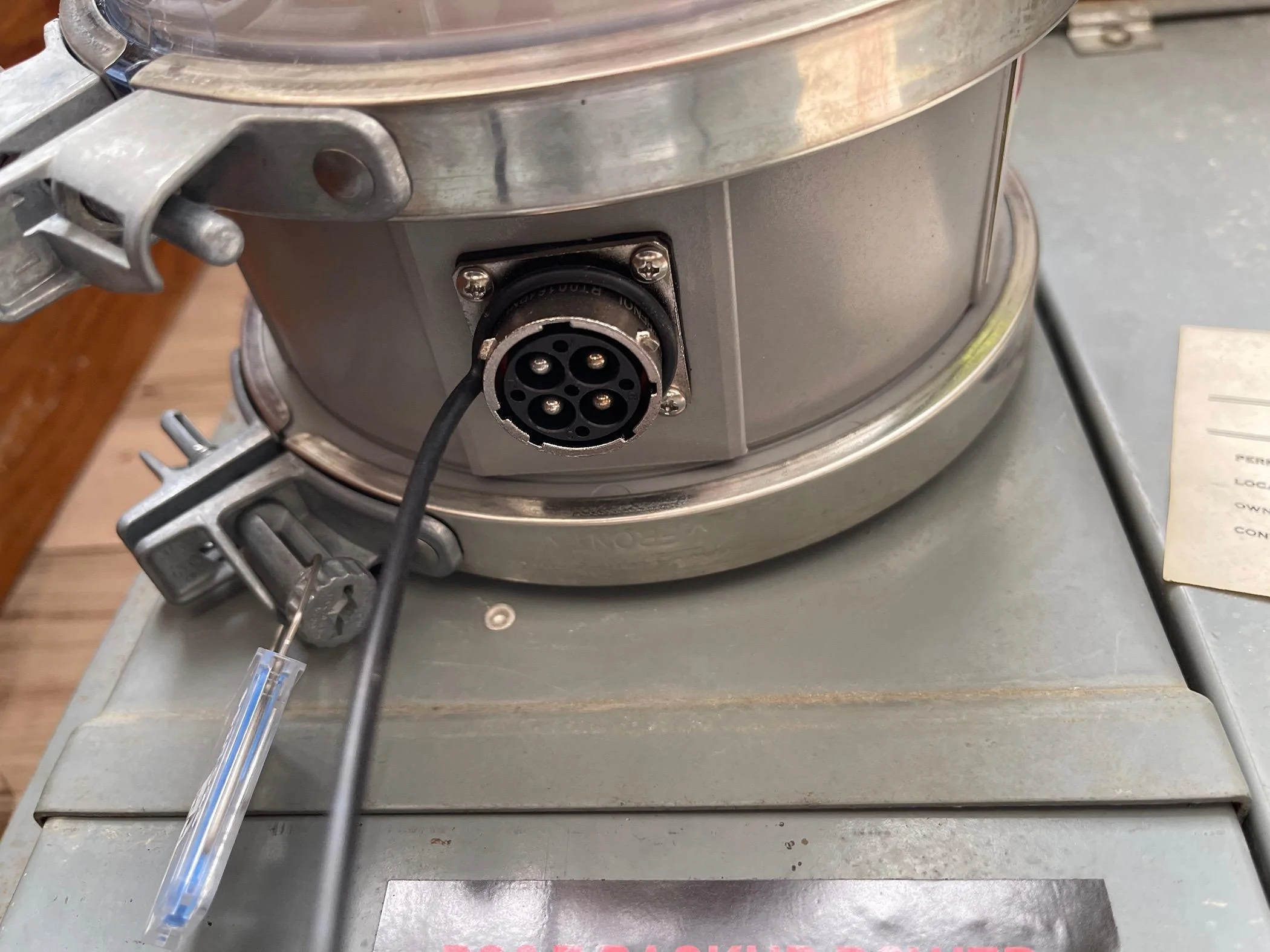

I have a back up system. It is called an extension cord. Unless you are loosing power regularly, a little inconvenience is not gonna kill you.
You are correct sir!
Here is mine!
And it powers the whole house!
This is what @Ford Motor Company and the other OEMs should be pushing.
Ford F-150 Lightning GM’s proprietary V2H system goes on sale today IMG_4541
Ford F-150 Lightning GM’s proprietary V2H system goes on sale today IMG_4540
Ford F-150 Lightning GM’s proprietary V2H system goes on sale today IMG_4539
Ford F-150 Lightning GM’s proprietary V2H system goes on sale today IMG_4538
Ford F-150 Lightning GM’s proprietary V2H system goes on sale today IMG_4537

Nope! All taken care of in that collar. Plus those breakers in the cable protect the truck/generator.
That looks sweet. Getting lost on Tesco site. Do you happen to have part number or link to those?
Mine came for free from my local utility - PG&E in Northern California. I believe the utilities have an arrangement with Tesco. Check with your utility first.
I believe they are OEMing a device from Generlink:
https://www.globalpowerproducts.com/transfer-switches/generlink-transfer-switch/
Do be careful with this device though. I have read it does not support the bonded neutral issue like the Tesco unit does.
