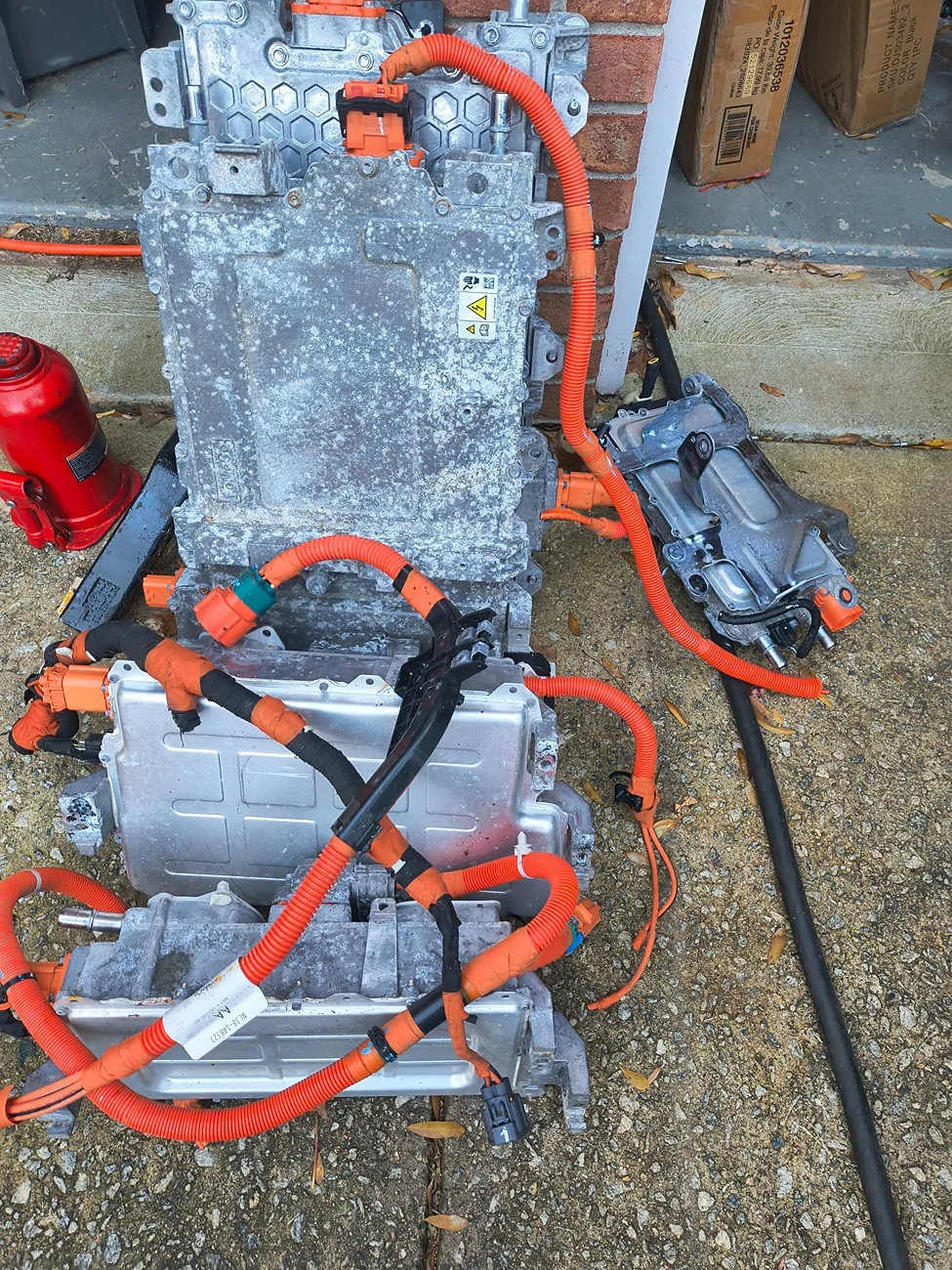

That's the onboard chargers, and inverter. Now to setup microcontroller / canbus controller to see if I can manage to get these modules running standalone for my camper.
@kdcool with your battery pack ebay purchase, did you also get the onboard charger and inverter? I do see you mentioned that in previous posts, just wanted to be certain. Did you replace all those SR components with their ER ebay replacements? Not sure about others, but I am curious to hear more details. Also more pictures. :)

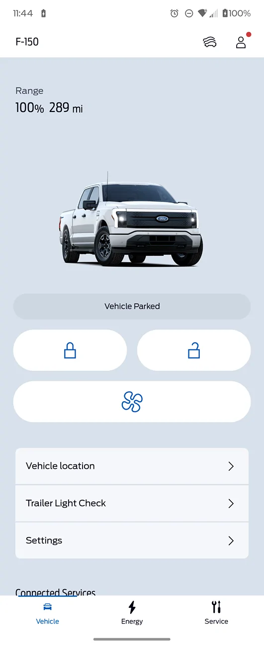

Hmmm, I hadn’t thought about FordPass changes. FordPass capabilities are tied to the VIN, so even though the truck recognizes the extra range, does FordPass? I’m assuming if you tell the truck to charge to 100% through the app then it would know to do that since the truck recognizes the larger battery…?
Interesting to think about. But I’m probably overthinking it.
No I just did the battery. No other changes.

No coding. Ford pass works just like before. Yes same electrical and coolant lines. Literally plug and play.
Ford F-150 Lightning SR to ER battery swap DIY project Screenshot_20251117-114457.FordPass

The SR battery pack is not ready for a solar setup as it is. Will need to talk to the internal BMS to activate the HV contact solenoids at minimum. Would also need a MPTT / charge controller that'd operate at the nominal ~350V as well as an inverter. Hence why I picked up the a lightning inverter and charger. I don't really care for solar as I have minimal roof real estate on the camper. I'd just level 2 charge it before I go boondocking. The expectation is that I'd run out of water well before I run out of power even if I had to run the campers rooftop AC for days.
