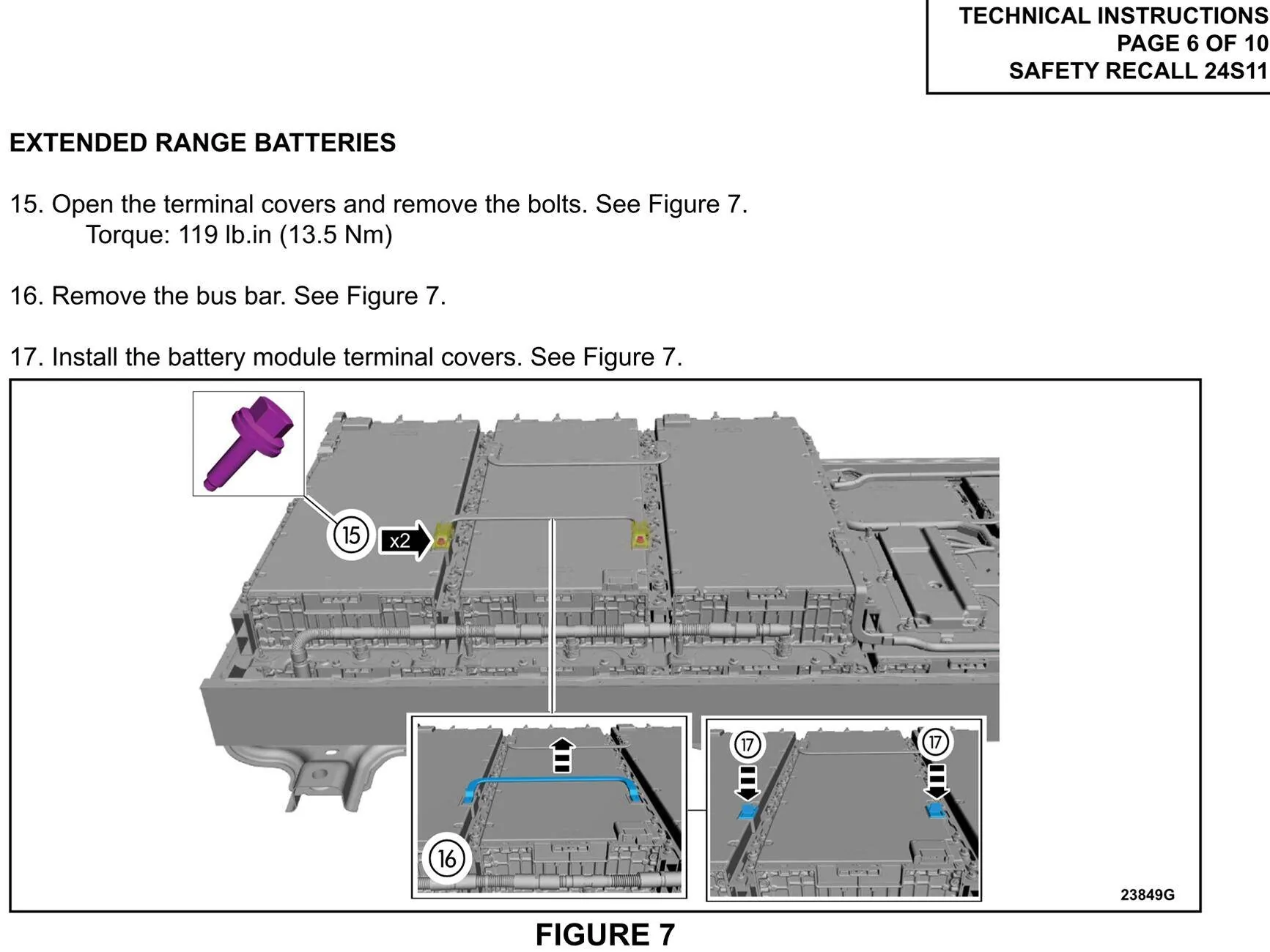

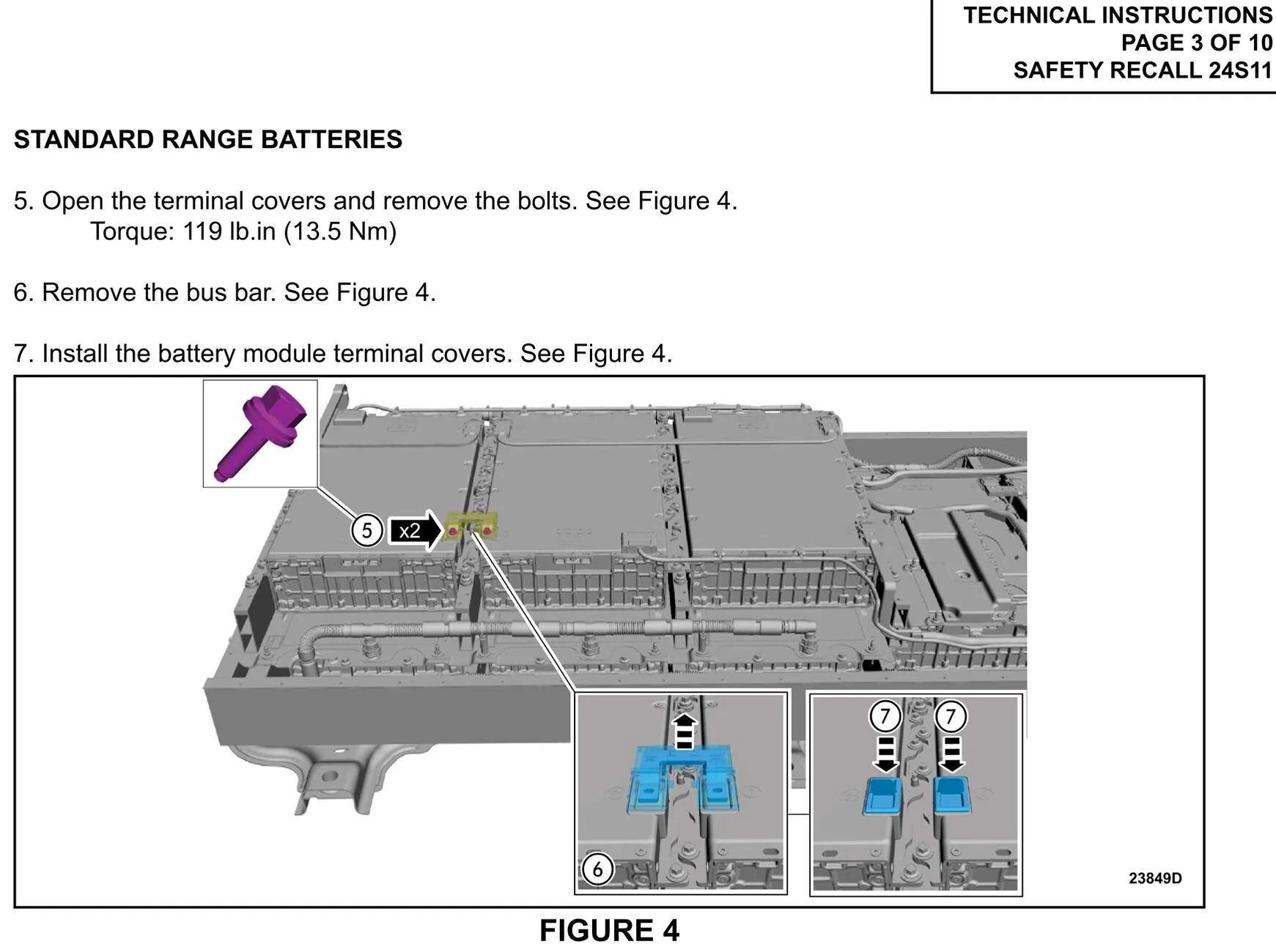

Finally I found, looking at this Safety Recall 24S11 for some re-torquing of HV bus bars of 200 Lightnings, Figures show different size HV battery modules for the SR vs the ER. This makes me think that @Ford Senior Master is correct on the SR using 9 smaller size Aluminum housings. Since the ER small module sticker shows 11.95kWh, 9 x11.95 is 107.55 kWh, this would match the overall SR battery pack sticker! So this would probably mean both the SR and ER cells are made up of the 5 pouches, but the SR only has 9 x 8 cells = 72, whereas the ER has the 96 cells. 96/72=1.33 ratio that matches the ER/SR battery output ratio of 131/98. Final answer? Using smaller modules would help account for the extra payload capacity of the SR trucks.

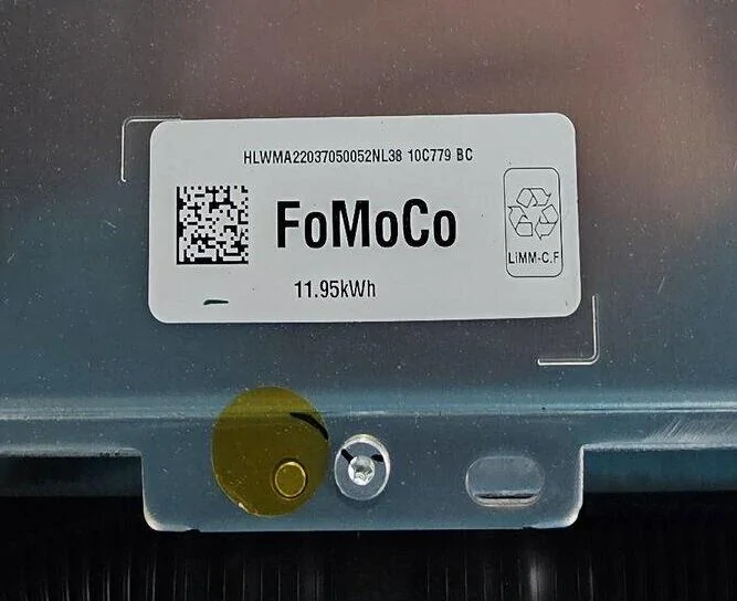

from a forum member photo of the ER small battery module #9:

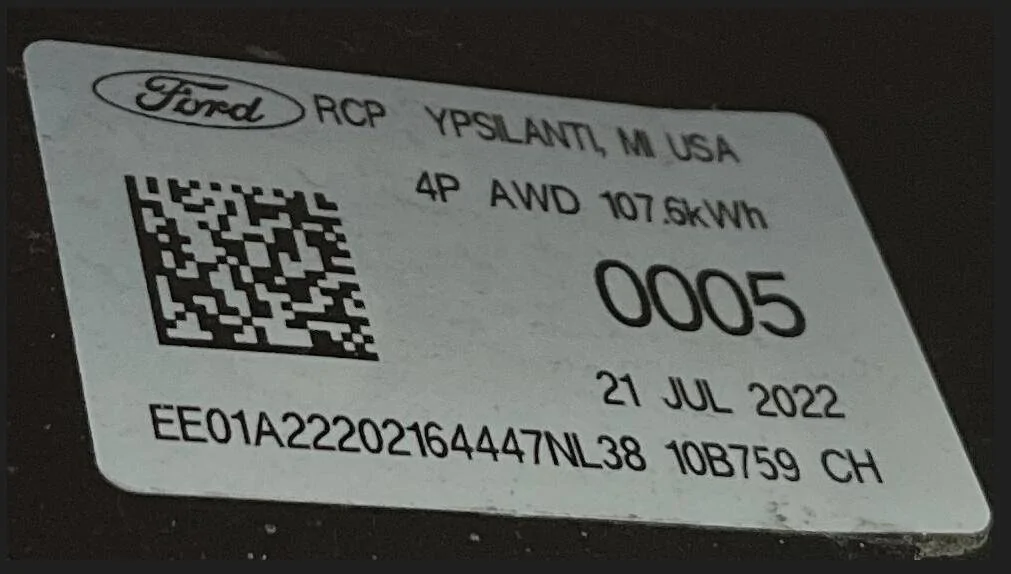

Another forum member had this shot of the Standard Range battery pack 107.6 kWh rating.
