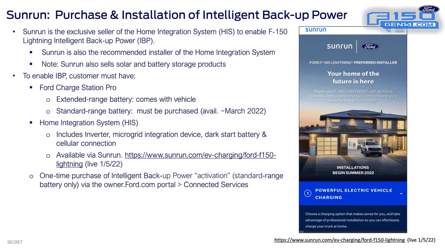

Last night during the charging live stream our buddy mentioned an undisclosed activation fee to enable the standard range battery to do the Home Backup. Does any one have any more info on this? It doesn’t seem to apply to the extended range vehicles. The fee is on top of also having to purchase the $1310 80 amp For Pro Wall charge and the Sun run equipment. I’d say to get a standard range battery to do Home Backup we’ll need at least $8k above and beyond the base vehicle price.

it IS true that the ER battery pack requires more/larger inverter/chargers for it's capabilities, and maybe that is what allows it to more easily integrate with the Sunrun home system - although I have heard nothing that specifically alludes to the SR battery not being able to do the same. I also imagine that you can easily use the 240v 30amp outlet on the rear of the bed for 'whole house' power thru a subpanel or main panel interlock, just the same.

From the the "playbook", it indicates you would purchase from owner.Ford.com for what it is worth.
I thought I read somewhere that activation is included with the purchase of the Pro Charger
It will be interesting to see how much said "activation" fee is???
