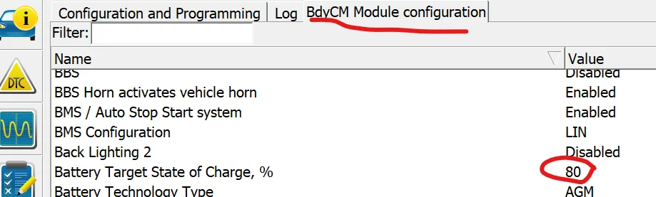

So, I fired up FORScan in Easy Mode to see if the BCM module for my truck had a 12V battery target state of charge %. It does!
Ford F-150 Lightning Starting to get LVB 12v warnings... 20240723 FORScan Battery Target Charge_Edt
To use FORScan in Easy Mode, besides the program and the right connectivity tool, you need an EXTENDED license ($12 for one year).
How to use Easy Mode is described in the following popular YouTube video: The guy who did this video is certainly at least a Libertarian! At the end, he shares a beer with an under-age-18 (non-human)! ?
So, the paradox is that if certain updates require an LVB % SOC > 80% to go into Inhibit Mode, how can the truck reach that in everyday driving if there is an LVB target % SOC of only 80%?! Makes me think that that setting in the BCM module must be vestigial.

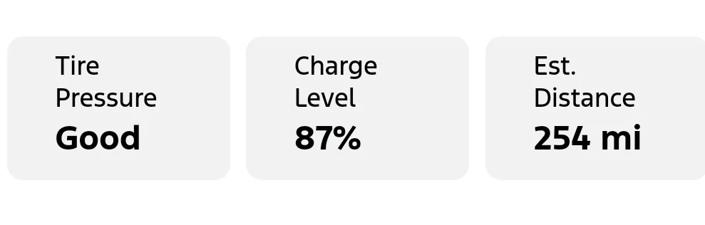

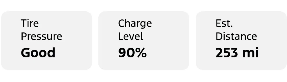

I haven't seen anyone post about the target being 80%, I have seen mine go well into the 90's and as high as 99%
Looked at my account dashboard this morning, the truck has not run since 2 pm yesterday, and I didn't play with Fordpass at all since then, this is the last reported LVB SOC at 90%
Ford F-150 Lightning Starting to get LVB 12v warnings... 1721821242926-y5
Then I woke her up with a lock/unlock command and now it's only dropped to 87%

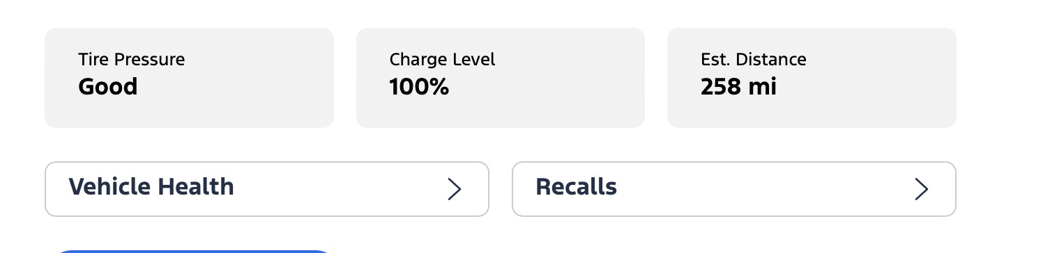

Checked mine this morning and it is 100%. Have not driven truck in two days.
I see 100% a few times, but usually in the high 90's.
Ford F-150 Lightning Starting to get LVB 12v warnings... Screenshot 2024-07-24 at 7.58.18 AM

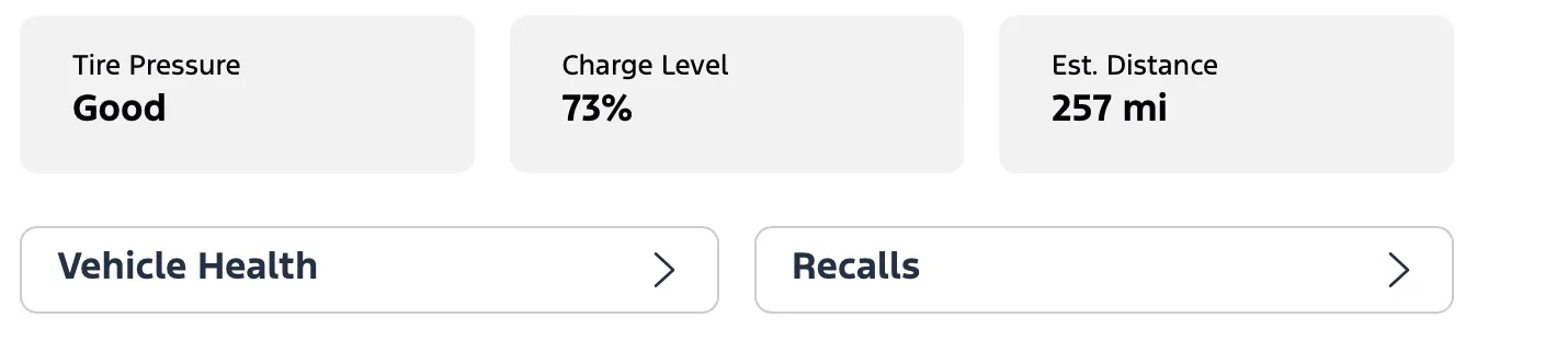

Well just sat in truck for a couple of minutes and turned it on. Came back inside and checked battery level again. Now it is 73%. Guess the battery value shown is when truck was last turned off.
Time to go for a drive. :) .
Ford F-150 Lightning Starting to get LVB 12v warnings... Screenshot 2024-07-24 at 8.17.16 AM

My basic question is, what is the use of that setting in the BCM module?
Maybe an off-the-wall suggestion, but could the battery target state of charge % be a lower limit rather than an upper limit, i.e., the % SOC below which OTA updates requiring inhibit modes won't run?
If that were so, changing the limit to 75% would allow such an OTA update to run when the 12V battery was below 80% SOC (but still >=75%).
Perhaps I should post my question in a FORScan thread...
Possibly this is code for ICE trucks using similar BCM hardware?, I don't really know, maybe the Forscan / FDRS experts can expound.
