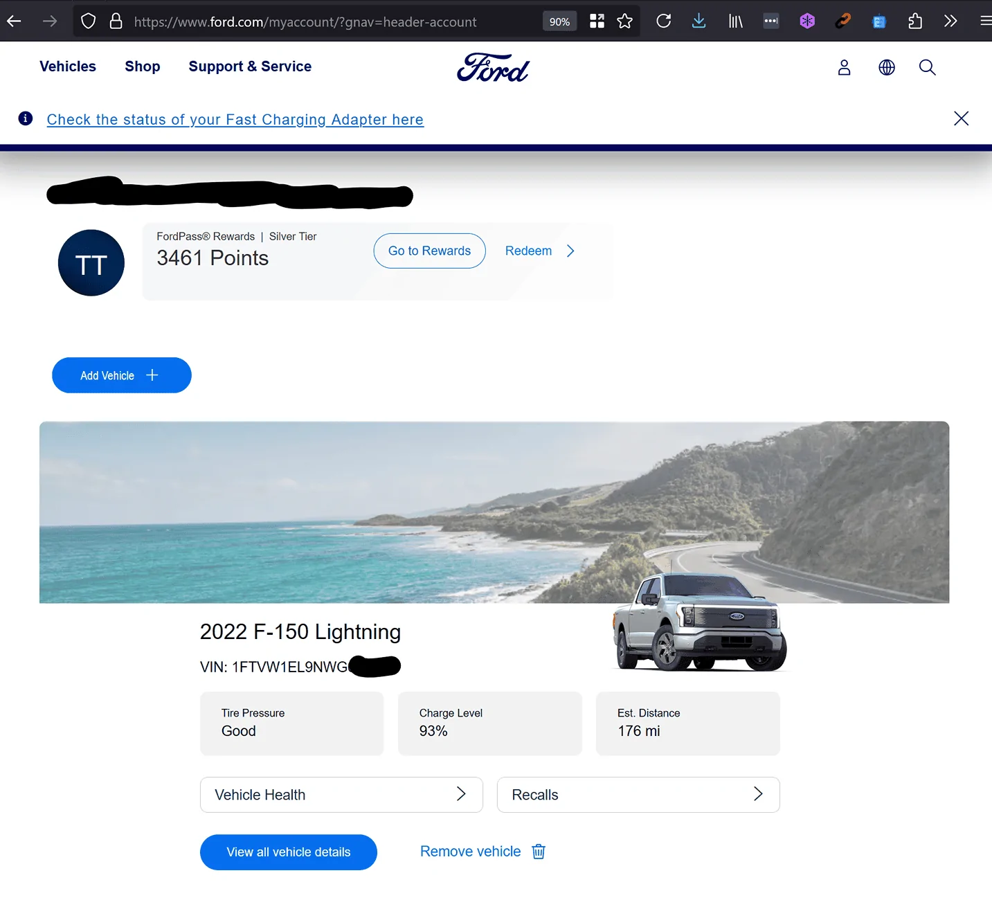

Not seeing anything about the LVB % SOC there, but it says everything is currently fine with the vehicle.
All that shows is Tire Pressure, Charge Level and Current Mileage.
Is there a sub-menu for the LVB?
The "Charge Level" is the LVB % of charge status.
Definitely need the new Battery Monitor Sensor to keep the LVB charged up. I am usually in the mid-90% range when I check.

On my dashboard at Ford dot com, the 'charge level' is clearly the HVB in miles:
Ford F-150 Lightning Starting to get LVB 12v warnings... charge level
I looked around for anything about the LVB charge level but nada.
Maybe because I have a Pro, I don't get as much info?
Sorry, one must go to the Account page, not the Vehicle dashboard. Strange, but true.
Ford F-150 Lightning Starting to get LVB 12v warnings... 1721421178326-4r
