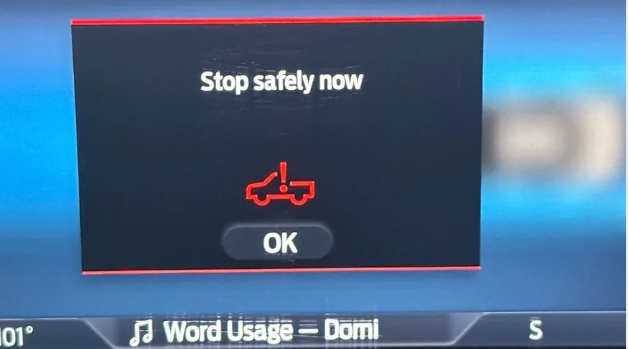

I got in my truck today and got this message saying stop safely now. The truck would only go into accessory mode and would not start. I just replaced the 12v battery at the dealer in March. When I looked at it, it’s swollen. Dealer tested it and says it’s fine. I’m having it towed and we’ll see what they say. I have little to no confidence that Ford will figure this out easily.

If the 12v battery goes, then the HVB contactors will not close and the stop safely now can appear - it has happened to some owners.
But any part of the 12v system could be the problem.
In one case disconnecting the 12v battery for a few minutes then reconnecting worked, and in a couple others just turning the truck off and on a few times solved it, or letting it sit 40 minutes and it was gone. Those might also have involved a 12v glitch and HVB contactors not closing.
https://www.f150lightningforum.com/forum/threads/“stop-safely-now”-message.14471/
It could be something else of course.
I think I recall someone having chewed wires that caused it?
And if there is an HVB cell in a module failure, that message would appear as well.

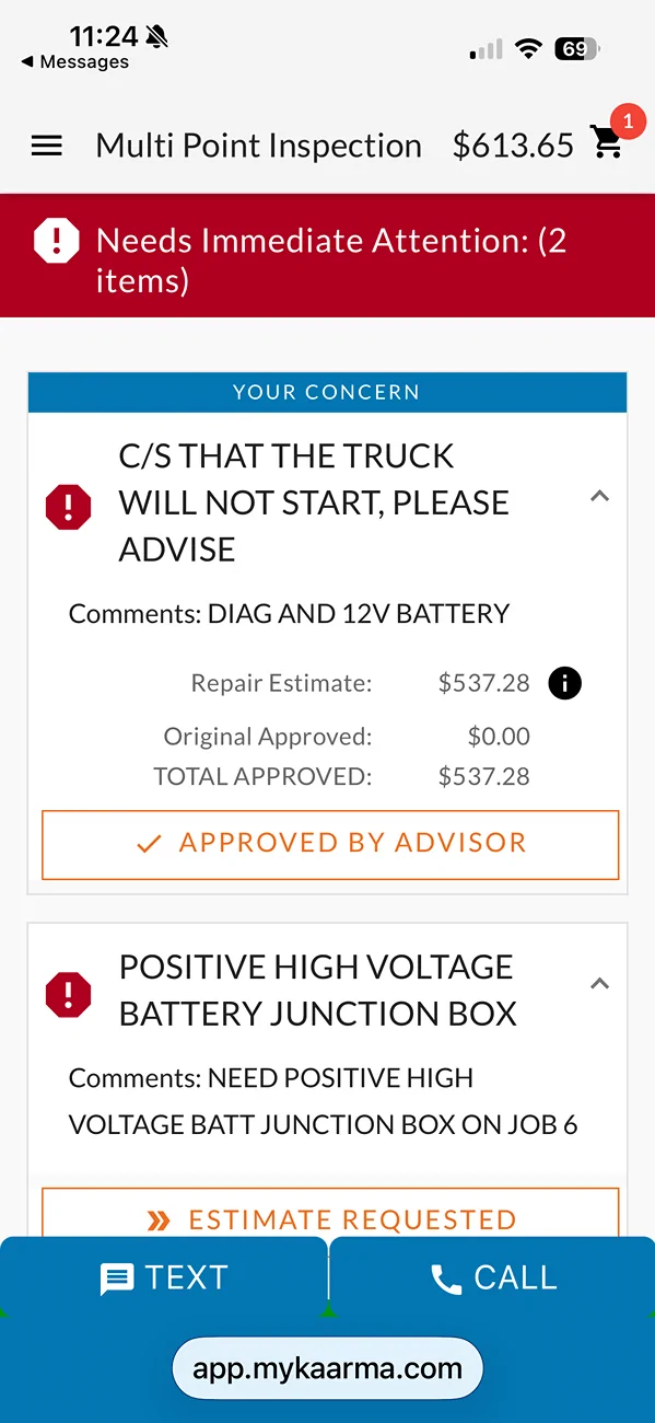

Just got this message from the dealer. First he said it was the 12v battery. Then when I called him and asked about this message he told me he hadn’t seen this yet. So I still don’t know if it’s just the 12v battery or the hi voltage junction box (or both).
