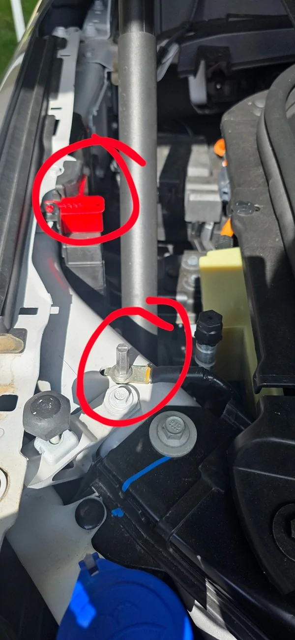

I had my first "Stop Vehicle Now" message (and forced stop). It occurred after I had been driving for about 15 minutes in One-Pedal mode. At a stop sign, I turned One-Pedal off and the warning popped up right after that. It was resolved by turning the vehicle off and back on again. As someone said, my confidence in the vehicle has been shaken. As of now, if this happens again, all I know to do is: 1) Turn vehicle off and back on, maybe several times, to see if it resolves. If not, 2) Remove and replace the negative battery cable. 3) Charge the 12V battery using the terminals in the frunk.
Is there anything else I should add to my checklist? And one final question: at what point would I take it to a dealership (hoping not to wait until it needs to be towed in)?

I'd take it to the dealer now to have them check codes and get the problem logged or fixed if there's any codes that point them towards something. Depending on your mileage, a 2023 should still be under warranty. Even if they can't find anything, if you get the complaint "logged" now and it happens again, you'll have the issue listed in the service records to help support your case.
