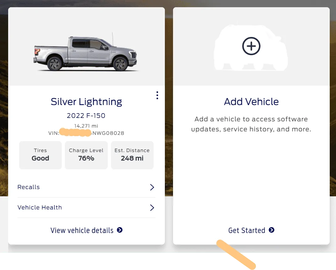

Log onto your FORD.COM account, see if the truck is still listed in your account dashboard.
Ford F-150 Lightning FordPass App - No Longer Shows Charging 1702652327760
Hopefully you still see it, if so, the data on your mobile device is somehow corrupted.

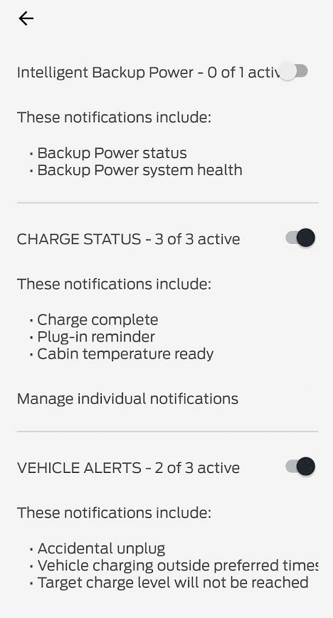

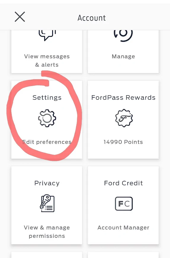

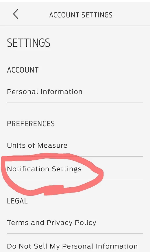

Some additional things to look at:
In the truck, on the Sync settings are you sharing all data?
In the Fordpass app, look at these settings in account:
note I do not have a HIS for backup home power so I turned that feature off.

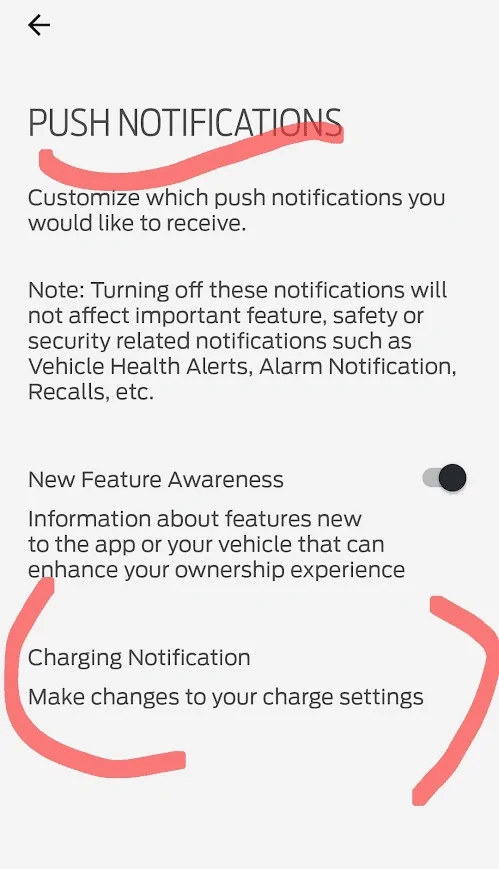

Thanks for trying to troubleshoot with me @TaxmanHog.
My app looks just like that for push notifications.
I saw your post in another thread with a screen shot of your app. Here's all I see.
Ford F-150 Lightning FordPass App - No Longer Shows Charging 1000001741

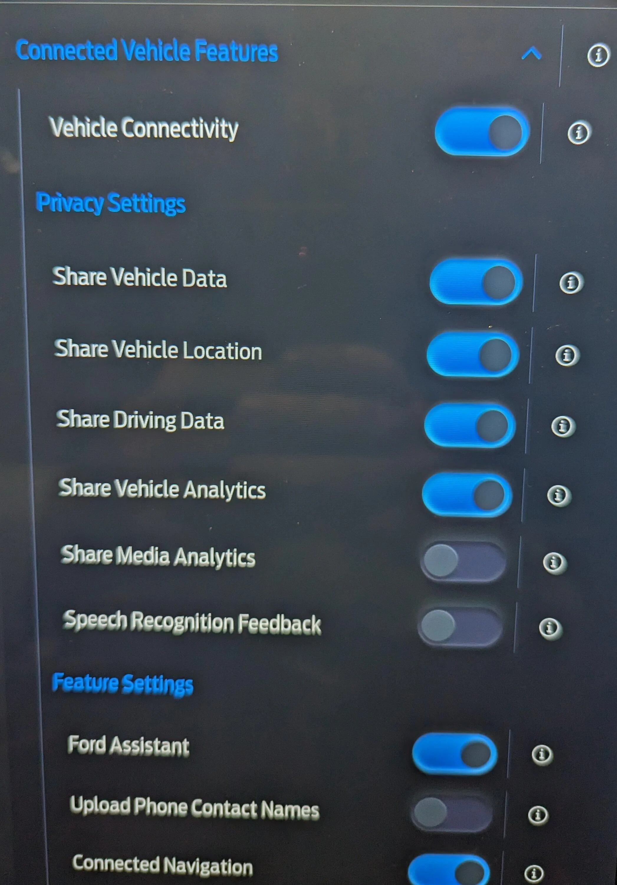

And here's what I see in the truck
Ford F-150 Lightning FordPass App - No Longer Shows Charging 1000001742
Seems as though you have the proper settings, I'm puzzled at why some elements are missing.
Ford F-150 Lightning FordPass App - No Longer Shows Charging 1000001742-jpg
Try flipping the primary setting off, then on and reselect the subordinate settings you're comfortable using, there might be a ghost settings glitch that you'll "undo" with this technique.

I've recently experienced this same issue, and I'm confident that I found root cause for my situation. Seeing this thread I decided to do an experiment.
I started charging my truck and completely disabled the vehicle connectivity. I added each option one by one. The Ford pass app started showing the charging info again after the share driving data option was enabled. To confirm, I enabled everything that I wanted enabled and then disabled driving data again. The charging info disappeared. Enabled it again and I've had uninterrupted charging info for 5 hours.
I had disabled driving data a month or so ago. Kind of frustrating that the info button doesn't show charging data in the list of data collected.
