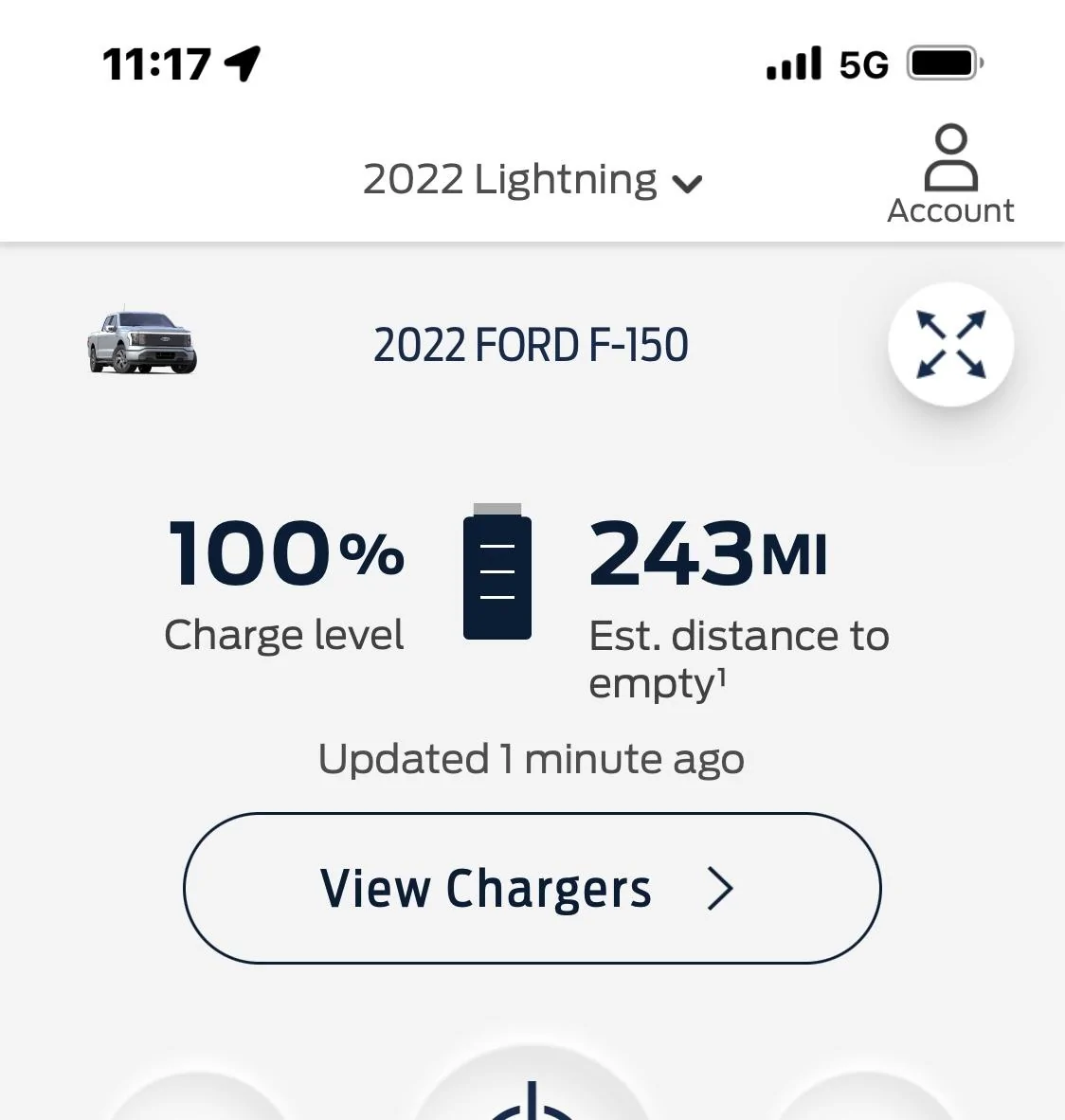

Yesterday - for my once a week charging routine at home (L2), I plugged in and Ford Pass app said full charge will be the next day (36 hours).
I found that odd as I normally charge fully after 4-5 hours.
My charger app showed full rate (11kW) consistently for 4 hours (44kW).
After 5 hours, app showed full charge of 100% but my app said tomorrow night will reach full charge...
Anyone see that ?

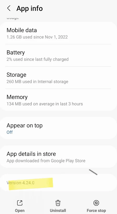

What APP version are you running 4.24.0 [android or ios version]?

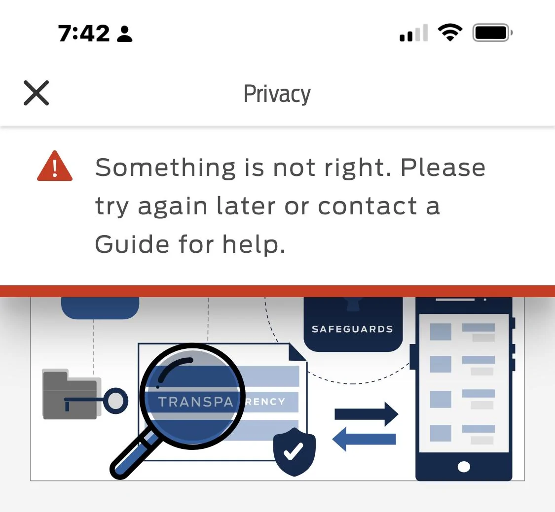

Where do I find the app version on an iOS device ?
I found something odd when I started to look around - privacy settings showed an error sign:

Hopefully an experienced IOS user can give you some tip's, but for android devices I can go into the APP control panel to determine a variety of settings and the version number.
The number might be slight different for either platform depending on when application development rolls out an update to the ios-app-store & android-play-store respectively.
