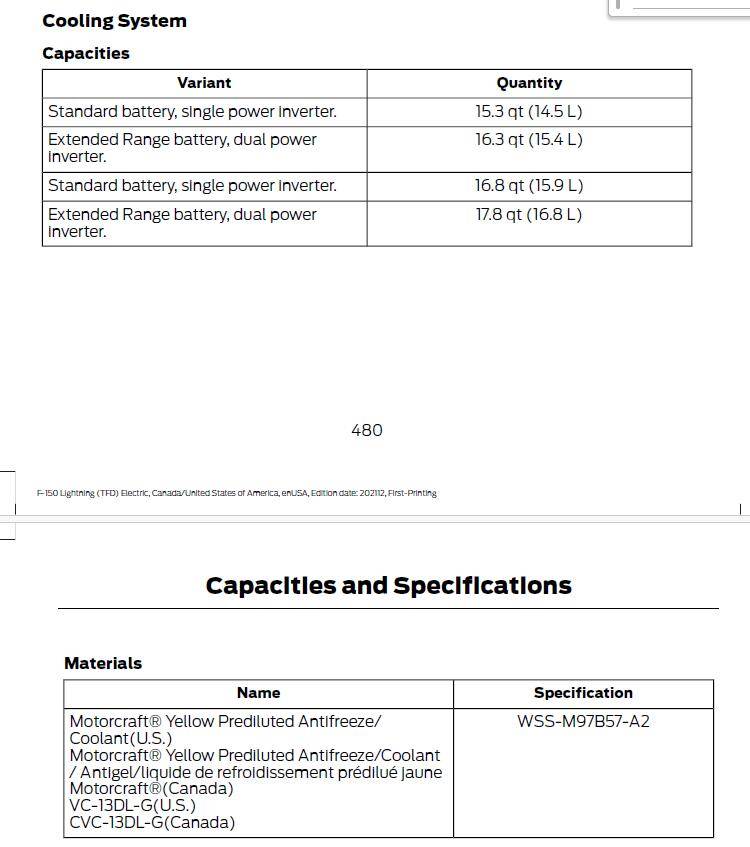

What brand/type of coolant are we supposed to use? I will need to check mine, wasn't aware this could be an issue after the module replacement. I did notice that the first time I charged after getting it back I was hearing some gurgling sounds from the battery area as coolant was circulating, and am worried there is air in there or not enough coolant. Will check when I get back to the truck.

occupying space
I do not get why there are four variants for the Cooling System Capacities. Must be for those who have the Max Tow optioni?
