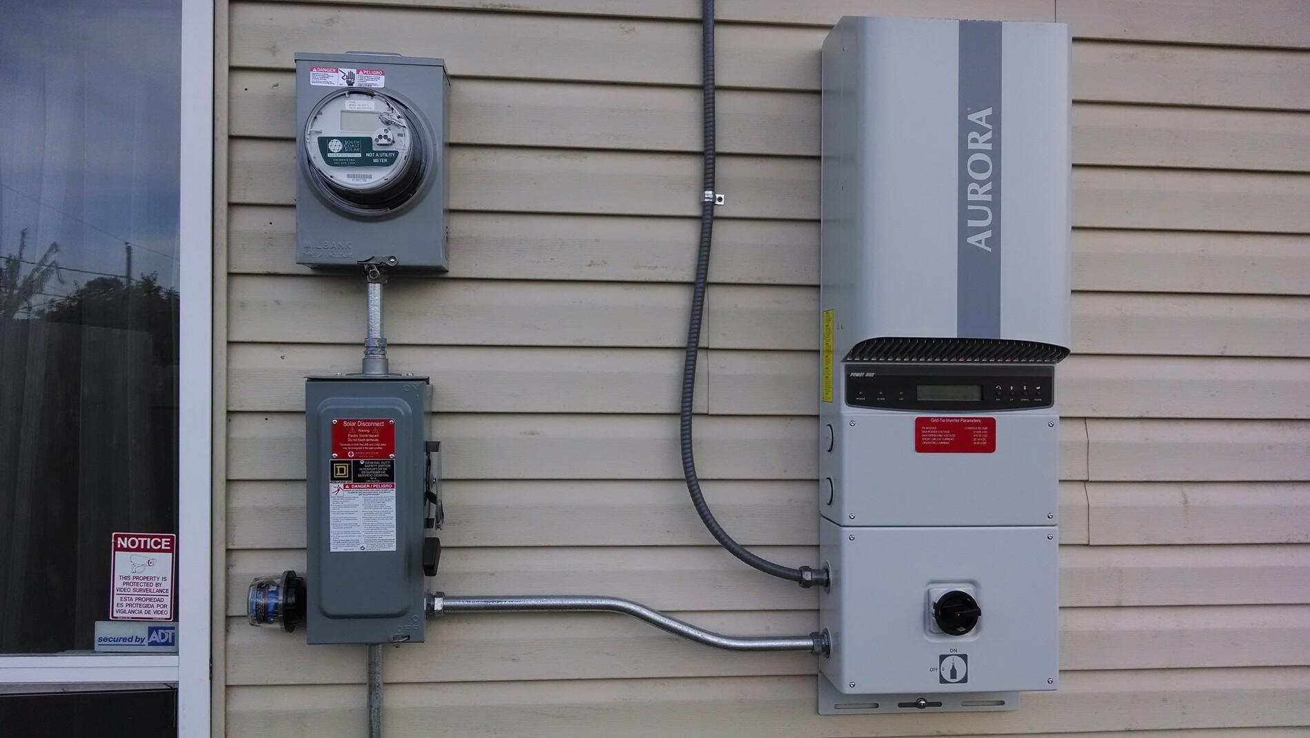

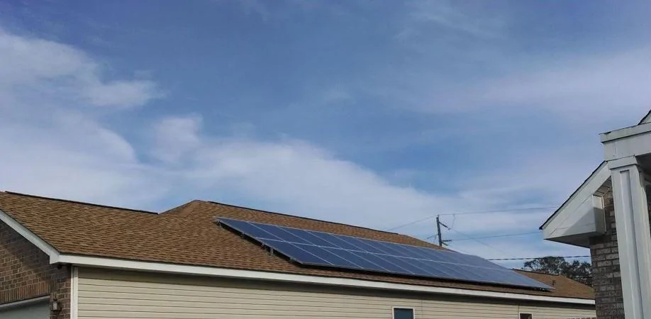

Have you checked your states limit for residential solar? In my state at the time of install, is limited to 6kW output. I told them when they came out I wanted my entire roof covered and that's when they hit me with reality so this is all they could install.
Wow, that's a shame about the limit. Our state has no such limit (or at least I did not approach it) so I am good to go
That looks like a similar setup to what I'll have once installed (although mine will be installed indoors.) Much appreciated!
