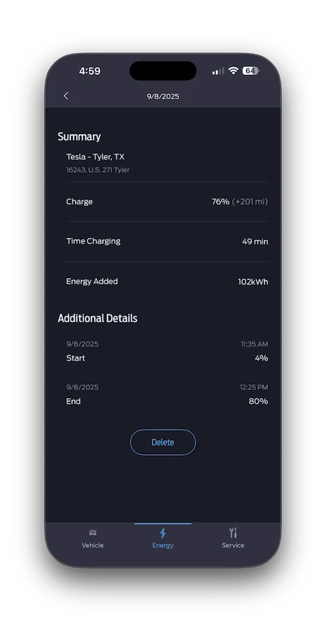

I recently made a trip from CO to LA and back and the V4 Tesla Supercharger in Tyler, TX rocked. I used the Ford NACS adapter and believe I averaged 125 kW over the 49 min charge adding 102 kWh in that time. (2025 Lightning Platinum 131 kWh)

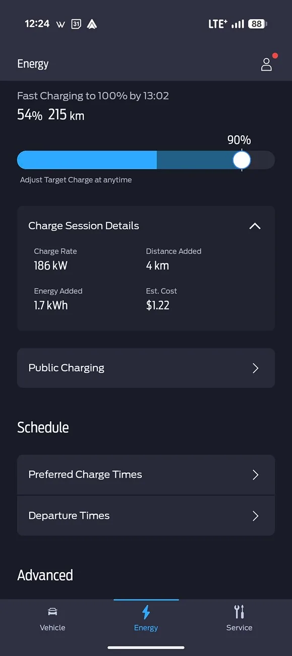

Ford F-150 Lightning Supercharger Avg Power Screenshot_20250928-122403
186 kW max, 16.77 kwh in 7 minutes, 143.75 kwh average
Yesterday: 33.874 kwh in 15 minutes, 135.49 kwh average
4%...you are a brave soul.
Nice - your V4 experience was at least 17% faster than what I experienced on V3. Tesla V3+adapter has a thermal issue slowing the charge substantially. (Folks highlighting their peak charging rate in this thread are missing the point). I started bringing my IR thermometer in the truck next to the adapter, but I haven't used it yet.
Your V4 125 kW avg delivering 102 kWh in 49 min is still slower than the @tommolog reported from EVgo 146 kW avg delivering 79 kWh in 32 min. That's another 17% faster than your experience at V4 Tesla, though different parts of the charging curve are involved: your 4-80% vs. @tommolog 20-80%.
@MDErnst - Do you also have the V4 20-80% metrics? We could better compare to @tommolog's EVGo (540A capable) experience.
MDErnst
Aug 4, 2025
Colorado
2025 F150 Lightning Platinum
I don't have that data for that session.

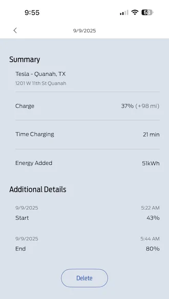

Ford F-150 Lightning Supercharger Avg Power Screenshot 2025-10-08 at 9.55.30 AM
Above is same trip but Quanah, TX, I believe these were V3 (?) 43% - 80% averaged 145.7 kW.
Edit: I also have Tesla Supercharger stops that were not nearly as productive as those shown above. I find my results can vary significantly from one Tesla Supercharger to another.
