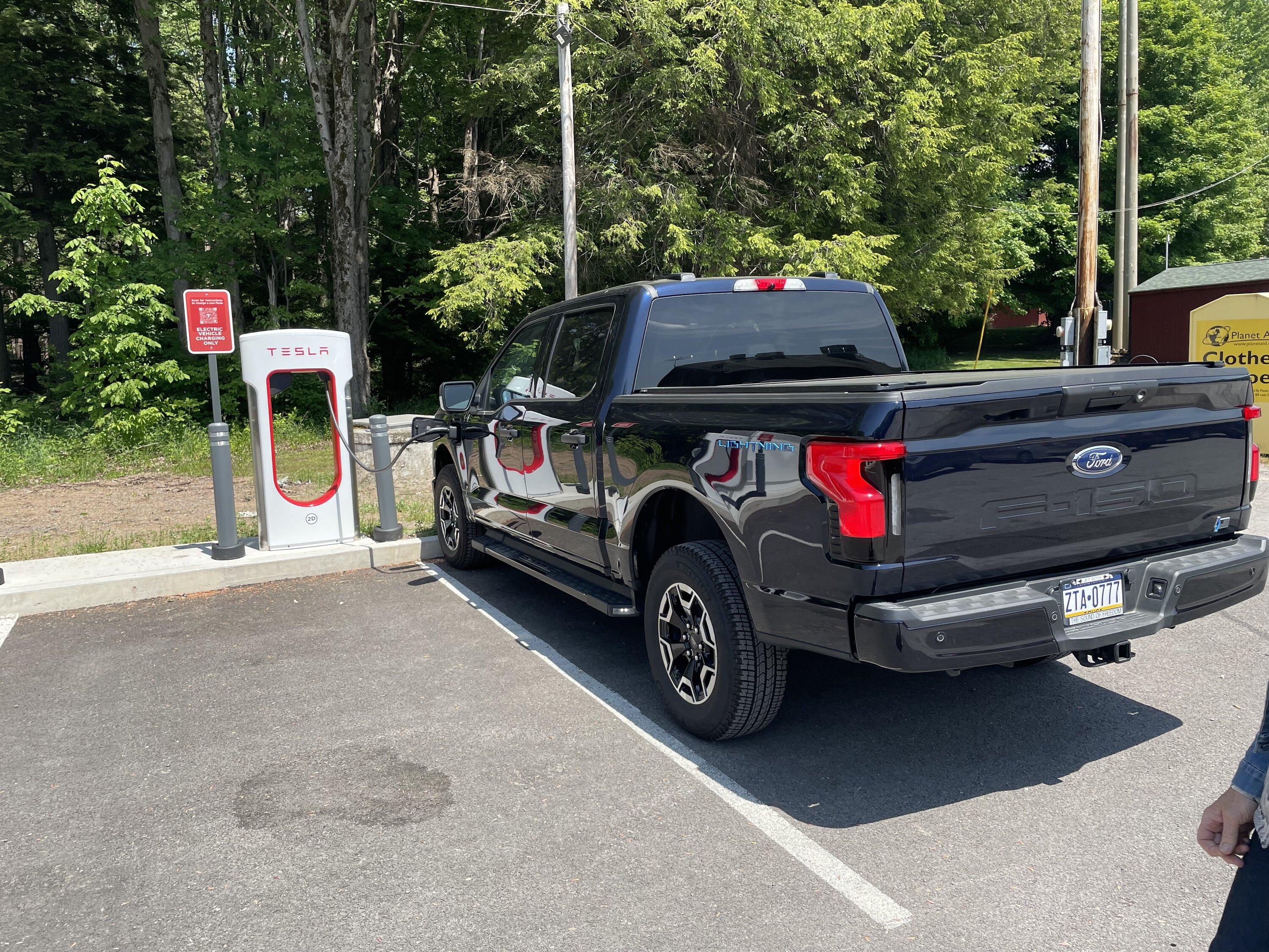

This is in mid-state New York. They work well enough, but the cables are too short… Hopefully the adapter that we can buy will include a few feet of cable.

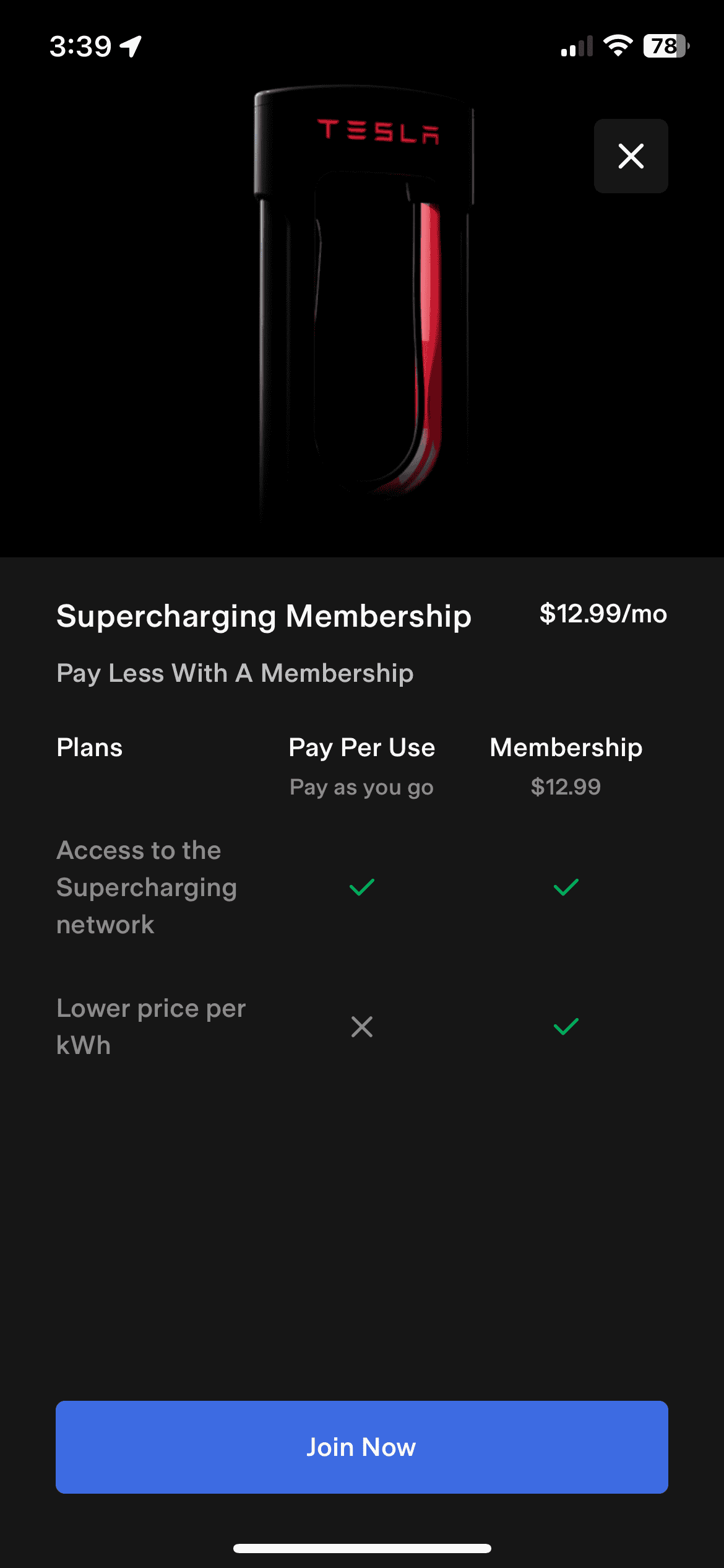

I was curious to see if you do find a magic dock how you can use it - https://www.tesla.com/support/non-tesla-supercharging
Then checked in existing app their "plans"
Yes, that's a known thing.
And, that in some areas, Tesla's rates are time dependent.
In all cases, I believe it's more expensive than EA's Pass+ rate.
