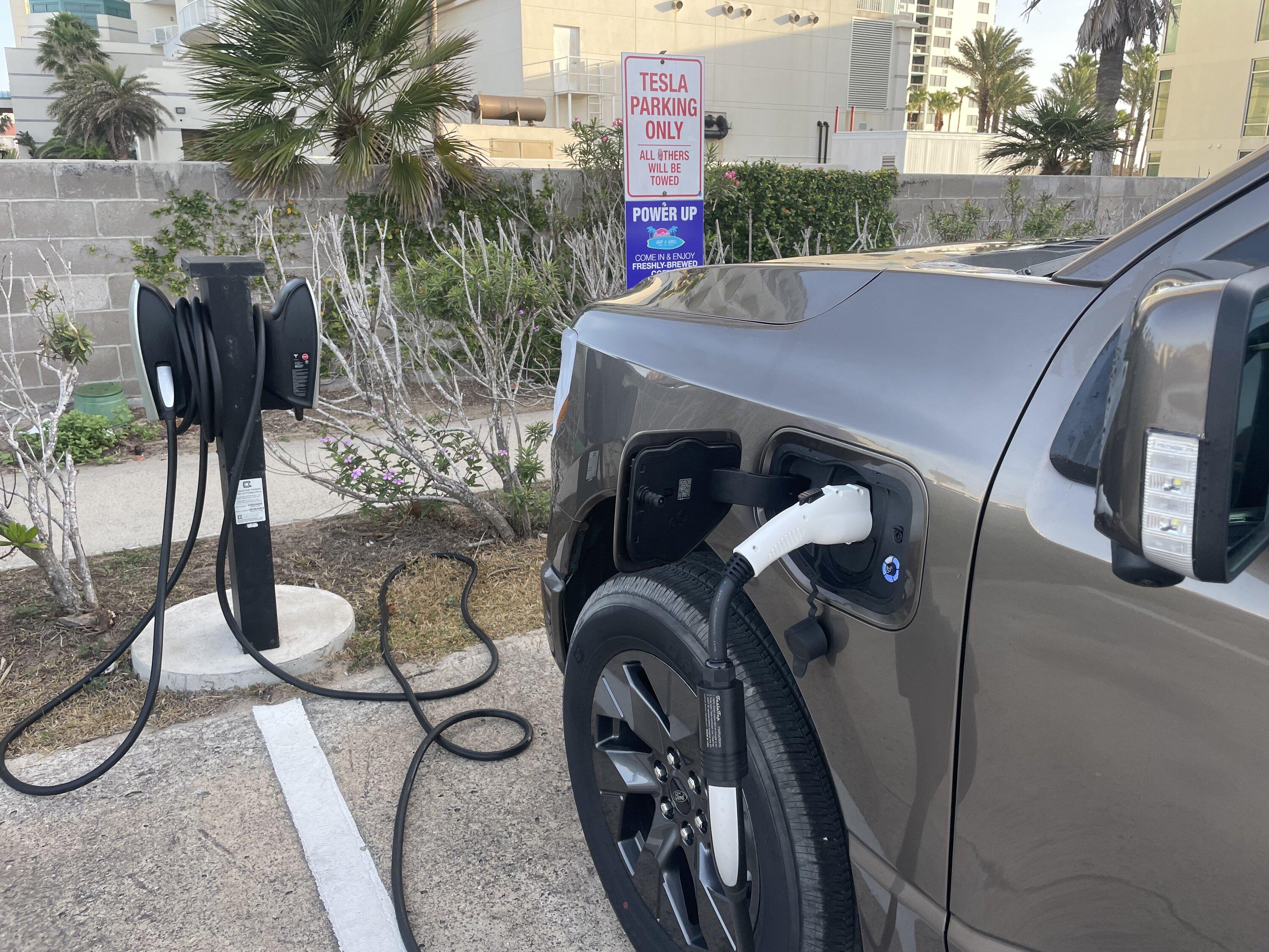

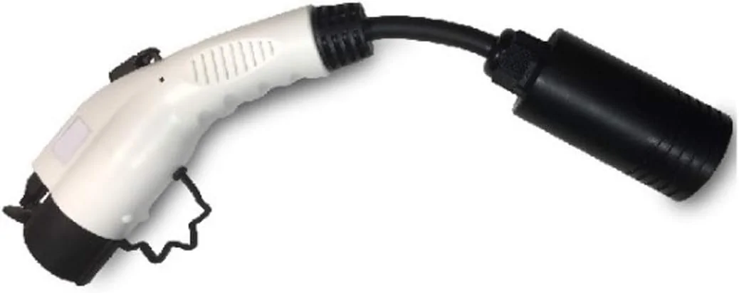

We enjoyed using the Tesla Destination Stations at a hotel in Texas. The TeslaTap - Tesla to J-1772 Adapter - 80 AMP worked out great. The hotel had both a Super Charger and 4 Destination Charger Stations. Charging was free and they offered a 10% discount at their restaurant if we mentioned we were using the Tesla Station.
