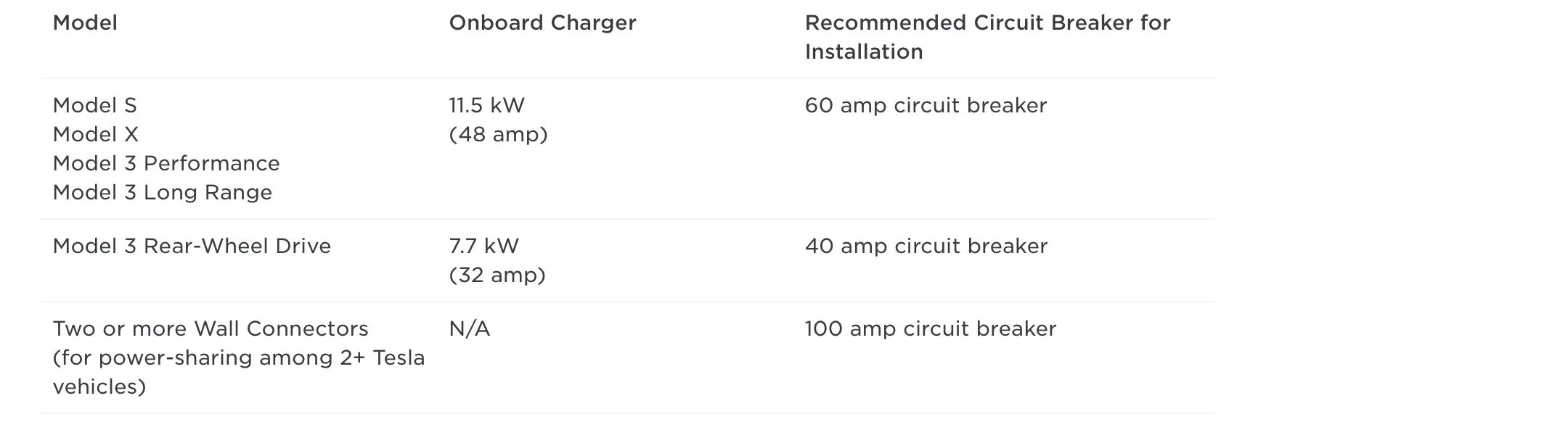

For ER folks, might still be better to go with TeslaTap and a Gen 2 wall charger to be able to get 80A. w/load sharing.
I'm ok with 48A (heck even 32A) the majority of the time. But the couple of times I've needed it, 80A was REALLY nice.
3,890
5,067
The gen 2 is 48A max. Only the original gen 1 was capable of 80.
Nope, my Gen 2s are 80A. Gen 3s is when they were reduced.
I've got 2 installed in my garage, load sharing and both capable of 80A.

Iā€˜m familiar with that link. This is what led me to make that conclusion:
Ford F-150 Lightning NACS + J1772 Home Charger -- Tesla Universal Wall Connector launched IMG_0592
I know older Teslas had 19 KW chargers. I suppose they could still charge at that rate with a gen 2, and the current modelsk internal Charger limits the rate to 48A?
That’s correct.
The charger adjusts to what’s plugged into it. And it can be dialed down just like the FCSP but for a maximum between the two.
If I plug my 48A MS in, it’ll charge at 48A. If I plug the Lightning in, it’ll pull 80A. If both are plugged in, it’ll drop the Lightning down to 60A and keep pumping 20A the the Model S.
I also have a 14-50 like @GDN and if I plug the Lightning in, the Model S in, the Model X in the 14-50, I’ll pull 128A from my garage panel. But the reality is 90% of the time I’m pulling less than 48A between all three cars. My Teslas typically get turned down to 12A. My Ford chargers at 32A on the 14-50 and it’s rare that even 2 cars are plugged in at the same time.
